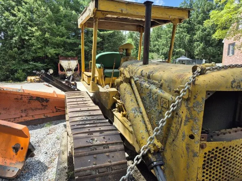

Anyone know what hydraulic fluid is supposed to go into the blade’s hydraulic? Could I use utf or is it iso 32 or 46 or a different weight

Mike, When I was in hwy mtc, our hydraulic oil for all uses was from Chevron, Hydraulic Hoist Oil is what we called it then. IHC had their brand "HY-Tran Fluid" which was red in color. I do not think it would make any difference as to "brand names" as long as it is Hydraulic Oil. In your photo, looks like a one way snow plow - "no eyebrow"? A piece of conveyor belting bolted on the top hanging down was a big help reducing the overblow effect, especially if you have "DRY" powder. Also looks like the leading edge of a "wing" alongside the Cat. --- cts

Thank you. In that picture that was the previous owners place. I didn’t have a picture of the hydraulic reservoir so that was the next thing. After looking more in the archives, is there any other hydraulic setups than a #46? That plow isn’t mine, but I have one similar that came off a Ford f700
