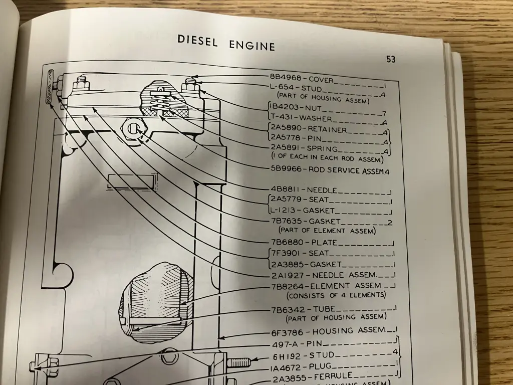

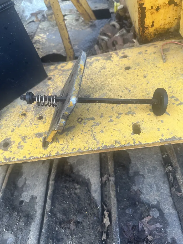

Does anyone happen to have the part numbers for the rod, spring, keeper ring and the ring at the bottom that holds on the filter for a Cat d6 9u

The 5B9966 service group is no longer available, have to by separate parts. Cat still has all the parts. Rod assembly 2F2154 nylon $14, 2A5891 spring $25, 2A5890 retainer $13, and pin 2A5778 $5. Original rods were made of phenolic plastic which always broke, or aluminum which lasted better but corroded bad with water in filters.

Thank you. I guess I wasn’t looking good enough in the online book
