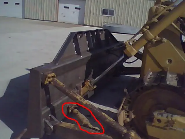

I have a Cat D4D 7R503 and i need some parts for my blade. Please bear with me as i do not know all the parts correct names. What I have is a 10ft wide blade with one tilt cylinder on the right side and a rigid brace on the left. What i need is the brace that runs from the left arm to the blade (horizontal to the ground) to keep the blade from racking left to right. The one on the right is ok, but i broke the one on the left this weekend. Can anyone help me? I think I have attached a photo with the part i need circled. Thank you, Dave.

You need a Cat # 2J4140 Arm Assembly (same both sides)
or if it's just the eye-bolt that broke a Cat #3F5567
Do a search in the construction equipment parts section of www.machinerytrader.com they have several listed...Regal being one of them, which has good prices on aftermarket parts.

Thank you for the information Old Magnet. I need the whole assembly as the one i have has been welded solid by the previous owner and parts are not replaceable on it. the right side is still adjustable.

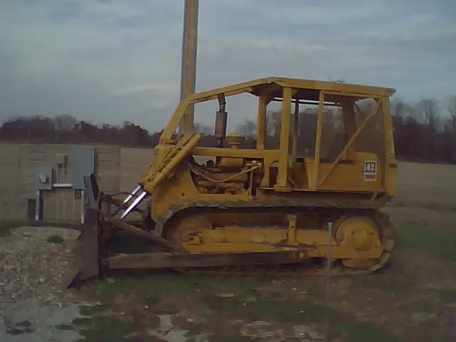

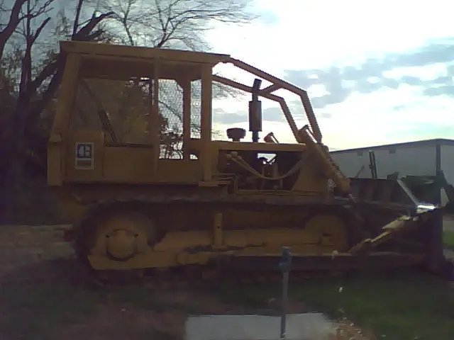

Looks like a nice LGP D4.It would be nice to see the whole tractor.
Thu, Nov 13, 2008 6:41 AM
ceo-cdr
Send a private message to ceo-cdr
Posts: 26
Reply to d4e:

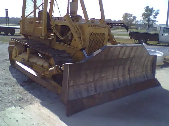

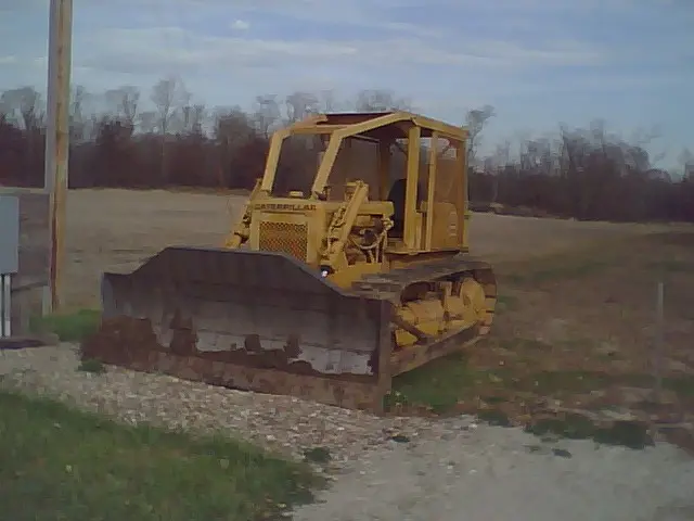

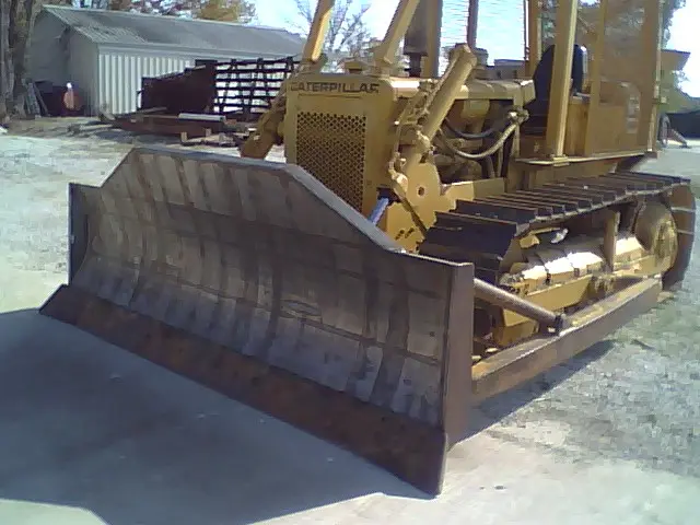

As requested, here are some more photos. the first two are of the blade at the fabricators and the others were taken when it got home. Not too bad for an eBay purchase.
Thu, Nov 13, 2008 8:17 PM
greyhead
Send a private message to greyhead
Posts: 57
Reply to ceo-cdr:
Looks like the fab shop did you well😎 VERY CLEAN! nice D4- Always nice to see good craftsmanship!😄
