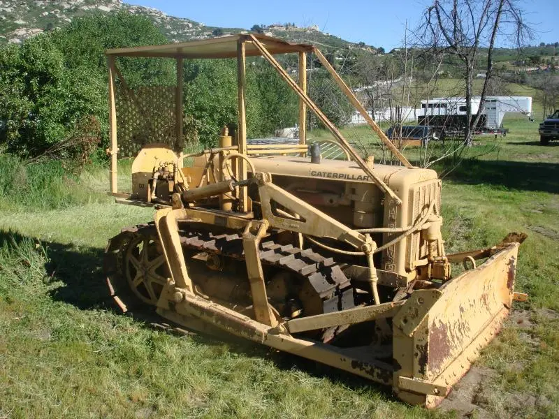

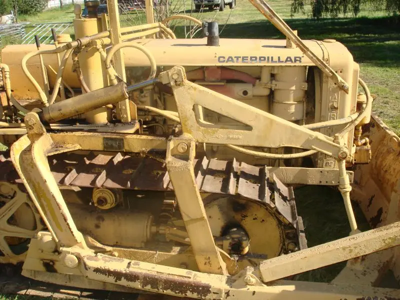

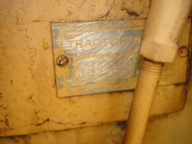

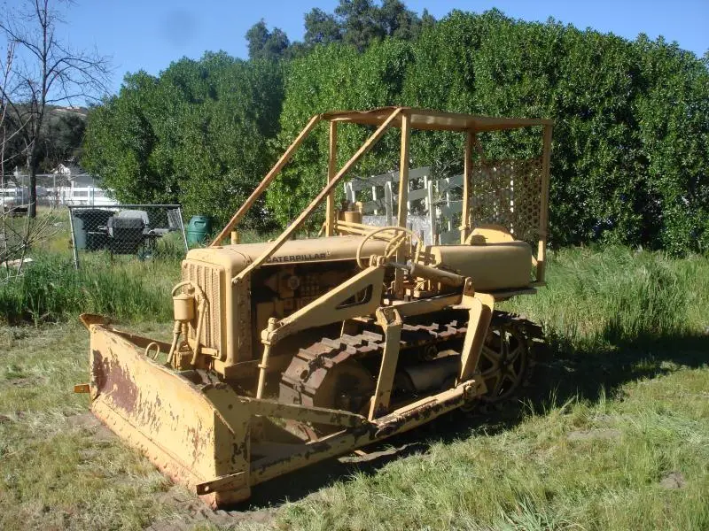

So I was looking at my machine and i read the serial number wrong it is a 5J not a 5U so the serial number is 5J1310 sorry for the mistake everyone.
The pony motor is seized up so i need to dive into that to that and see what the problem is. The main engine runs. we tow started it with a tractor. Here is a couple pics.

Could be as simple as a stuck valve. Or piston. But, usually is easy to get them running again. Simple little two cylinder gas motor. Don't go to electric start. Keep it stock. Will make the diesel engine last longer. It gets to warm up and get all its fluids moving before starting. When the pony is right it will start on the first pull even when the temp is 20 degF outside.The guys that go electric are just impatient and have to then deal with batteries. Just my opinion of course. It may be that I just like all the starting ceremony when you have a pony.

5J1310 is a 1939 according to the D2 tractor/owner listing over on ACME in the archived information section.
Do you have manuals? A parts book is really nice to have just to have a picture of what is there. You need one that covers the serial number range including your tractor. I expect it would be 5J1-5J3500 because the one I have is 5J3501-10561. The parts book covers the whole tractor and engine(s) as well as any CAT attachments that were available at the time (lighting systems, electric start, bumpers, PTO units etc). Blades and hydraulic units produced by CAT have their own books. Yours is too old to have had a CAT dozer from the factory. I wonder if it isn't a Bucyrus Erie. Any tags etc on it?

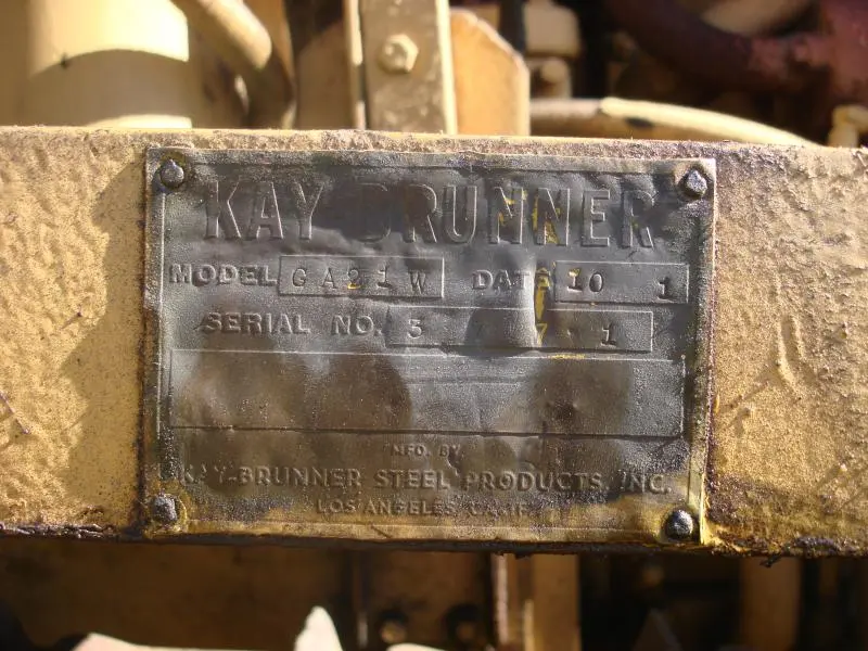

The blade has a tag on it from Kay-Brunner Steel Products Inc. Los Angeles, Ca. the whole tractor is in great shape I have wanted an old Cat for a long time and this one kind of fell in my lap and I couldn't turn it down for the amount I got it for. I just got out of the Marines and I am going to school for Diesel Tech so this will be a good little home project to restore over time.
