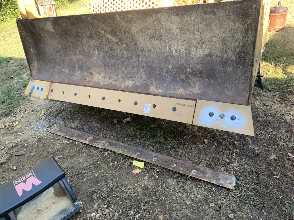

On a positive note I just finished up my new cutting edge and end bits installation this morning and while it wasn't an easy task I finally persevered . I used a Case center section because it was less than half the price of the factory Cat item . I also used aftermarket end bits because of the cost savings . All in all it looks and is way better than the wore out piece laying on the ground that some jackleg welded on to the existing edge to make do . I'm pretty sure that was the original cutting edge I took off . I cut all the old bolts off with a plasma cutter and did a good cleanup of the blade base before the edge went on .

Looks good and I can tell that they're not Cat because Cat edges are painted black : ) Doesn't matter - it'll still cut and push dirt like new

did you put some anti-sieze on the bolts. makes life easier the next time. unless book says specifically to put em in dry a light smear of anti-sieze on all fasteners. especially those in contact with dirt and moisture.

No just put them in dry . I figure the new edge will for sure outlast me and probably any future owners . The cleanup work I have to do won't take over a week then I'm not sure if I will keep it or not .
