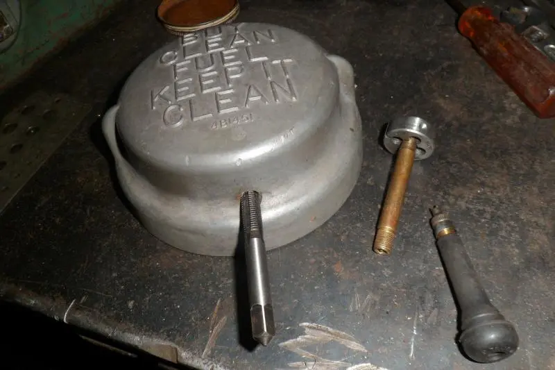

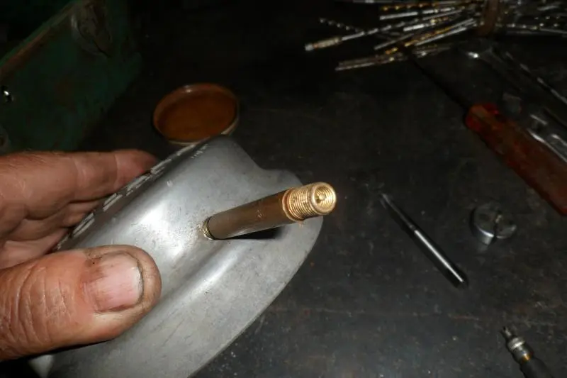

tap ur fuel cap and use a valve stem with matching threads, pressure ur tank, like about 15-25 pounds, bleed system with compressed air is the trick i use. dans right, leave filter.
[attachment=31939]SAM_2940.jpg[/attachment][attachment=31940]SAM_2941.jpg[/attachment]
[quote="ag-mike"]tap ur fuel cap and use a valve stem with matching threads, pressure ur tank, like about 15-25 pounds, bleed system with compressed air is the trick i use. dans right, leave filter.
[/quote]
That's to high a pressure and will balloon your tank. 5-10 psi max is what I would recommend and even 10psi is high. (figuring all those square inches of tank surface)
[/quote]
I use a rubber pipe cap 4" or 4-1/2" I think. Measure to be sure. I glue a valve stem into it. No clamp on the tank. It fits tight enough to hold enough pressure to bleed the system and if you go nuts and get to much pressure it will simply blow off with no harm done. Your cap will still be original also.
