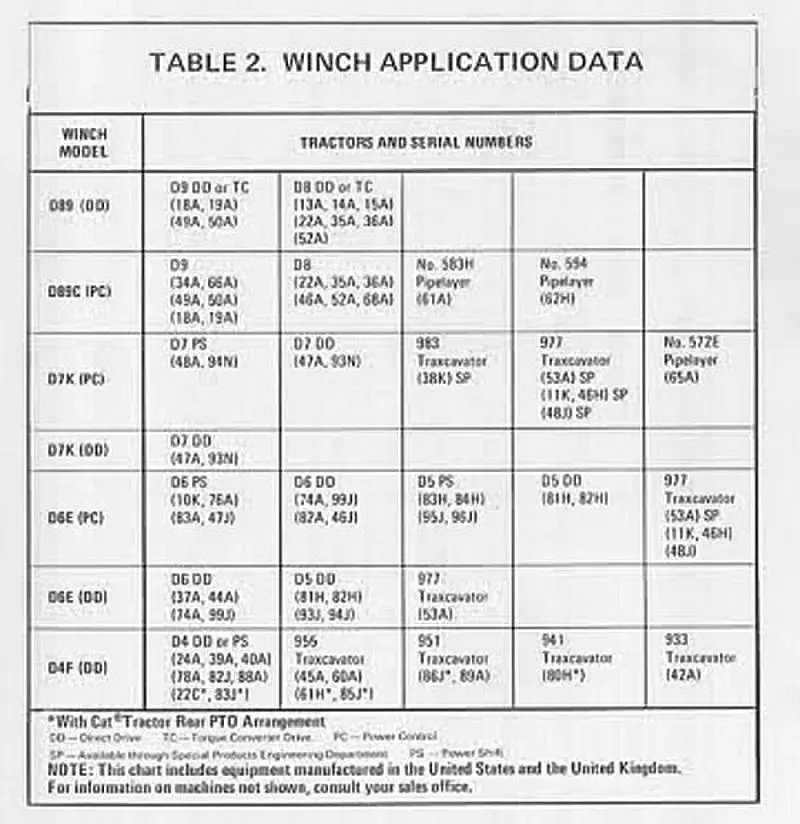

Does anyone know if a D8k winch will bolt up to a 983 track loader? I've seen D6 winches on the 977k loader so I'm wondering if I can do the same with the 983.
Thanks in advance.

should be the same bolt hole pattern on D8 and 983.

My Hyster winch application data book shows the D7K(PC) winch being used on the 983 (38K)-SP
Could be OM, but what else does a D7K winch fit? It is my understanding that the 983 is basically a D8H/K back end, but what Cat did with the drawbar bolt pattern, I don't know.

See for yourself....
Chart is a little fuzzy as I had to enlarge it from small booklet.

thank you guys; very good to know! makes sense that it would be the D7 winch given the 983 shares some final parts with the D7; at least according to Caterpillar anyway.

Hi, Old Magnet.
I had a shot at cleaning up your chart a little with GIMP photo manager and also enlarged it a little. Any improvement?
