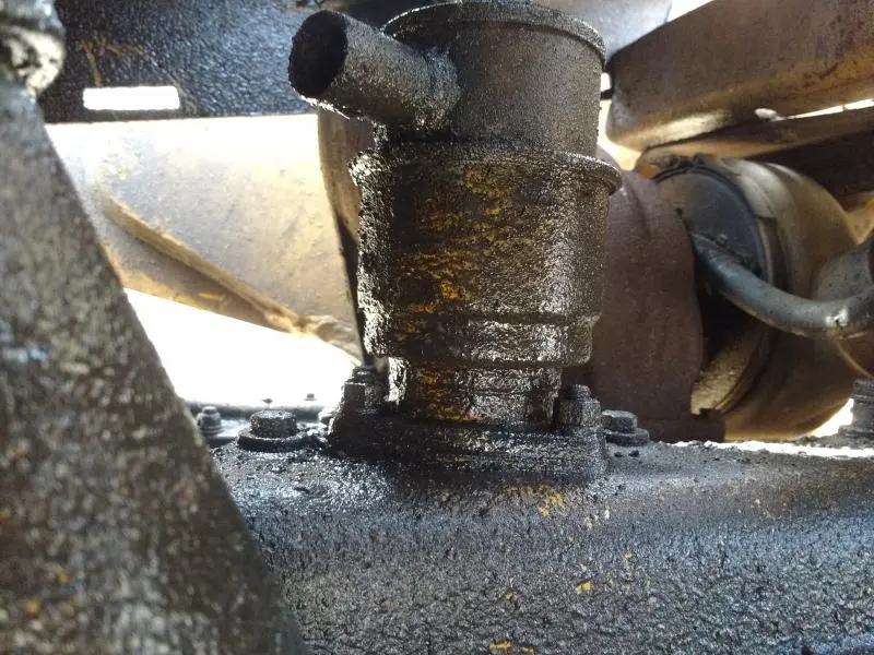

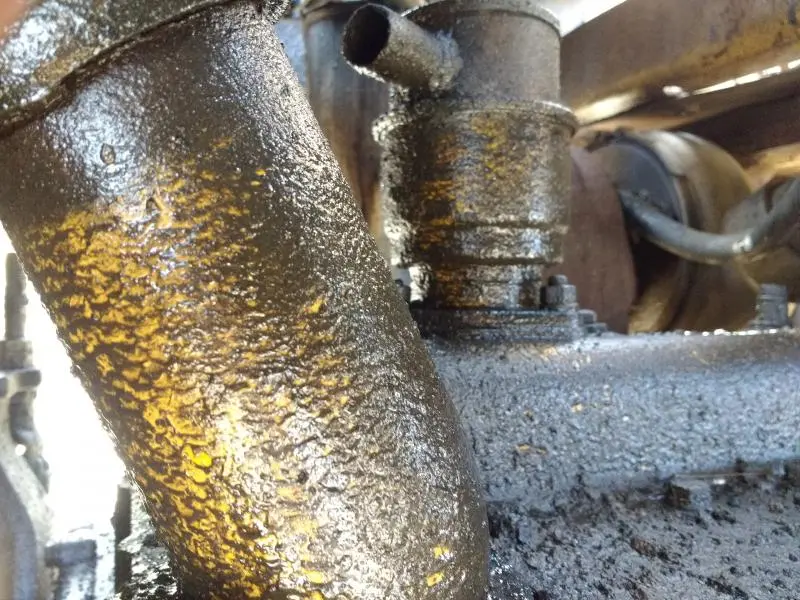

I took pictures of my breather to make sure I am describing it right.

Looked through my stuff and I don't seem to have a parts book for an Industrial D330A. That appears to be a bad case of blow by and oil discharge.
