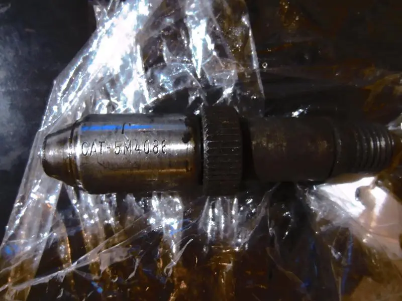

Today I get information that cylinder block number have this data 6A6397V -VO- FAPS MENRKR and on engine number 6A5546, can it help to detect machine s\n ? We also know that this machine is 1983 year build,951c and have a rear crane.
I make some photos of part (nozzle) which I need:
[attachment=12259]IMG_0456.jpg[/attachment]
I need all this unit. capsule,nozzle and something (dirty part) which screwed into the capsule. Is it 8M1584 or it only capsule + nozzle? In Russia this all element named as nozzle

Engine arrangement 6A5546 is for a 3304 engine model 48V1-48V1039
used in a 951C model 69H2520 - 69H3508 (1973-1974).
Your looking for the 2S4442 replacement nozzle as mentioned in above post. The 8S2389 body stays the same.

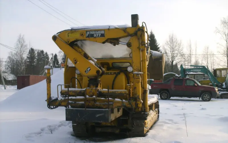

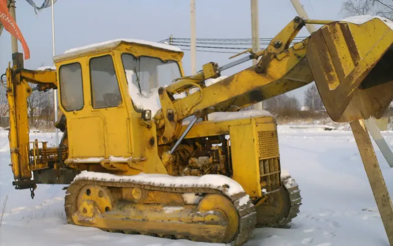

Today I get on my e-mail some photos of this machine. So, it is in average condition and need repair. Hope owner will bring it in good condition.
P.S. I watched a lot of pictures CATs 951c and at all different cabs. Is this cab custom or not?

Old Magnet,
Are you shure about 3S6638?
Here is your quote:
[quote="Old Magnet"]The 2S4442 nozzle, part of the 3S6638 group, is a 180 deg. counterbore nozzle. correct for NA engines.
The turbo'd engines use the 90 deg. counterbored nozzle #5M4086 part of the 8M1584 group.
The 977 uses a 5H2634 governor group and 5F1940 spring. Rack setting range is from 0.225, 0.205 and 0.150 in. depending on whether it uses the 9 inch fan pulley or cam shaped pistons.[/quote]
But in this engine were 5M4086 capsules, and it is not turbo ?:noidea:
