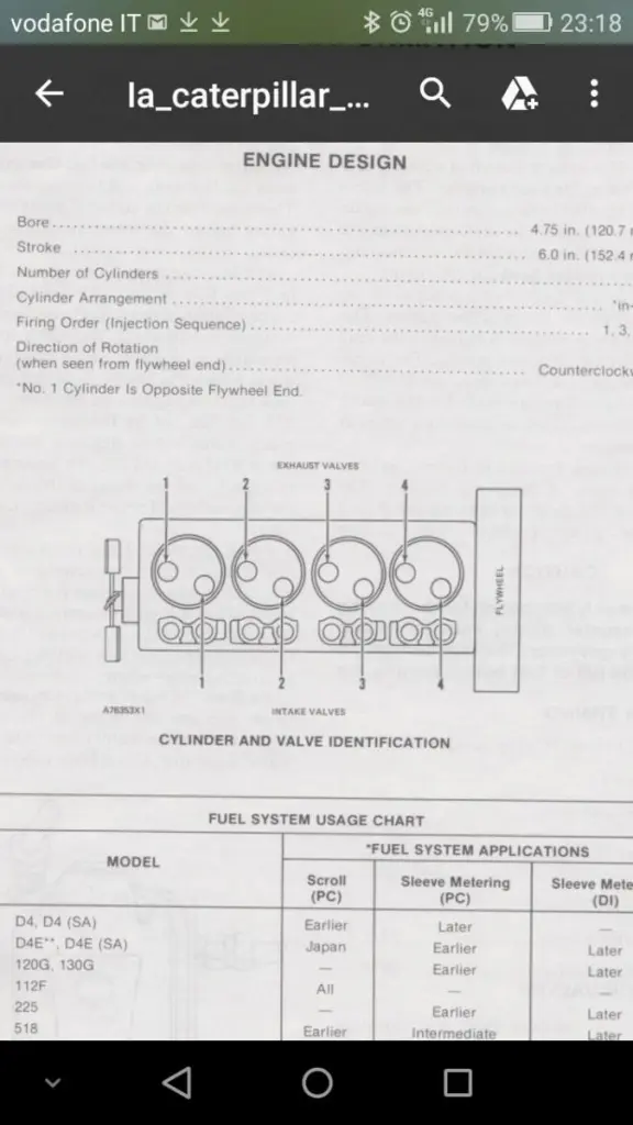

[attachment=54162]IMG_20190530_232306.jpg[/attachment]
Is this the order of the pistons?
piston 1 opposite the flywheel
Fri, May 31, 2019 4:31 AM

Evviva!!! you got it!
Yes, valve should be closed for adjustment.
#1 is at the front of the engine.
To check when done put #1 piston at TDC again. Both intake and exhaust should be closed.
Fri, May 31, 2019 5:24 AM
