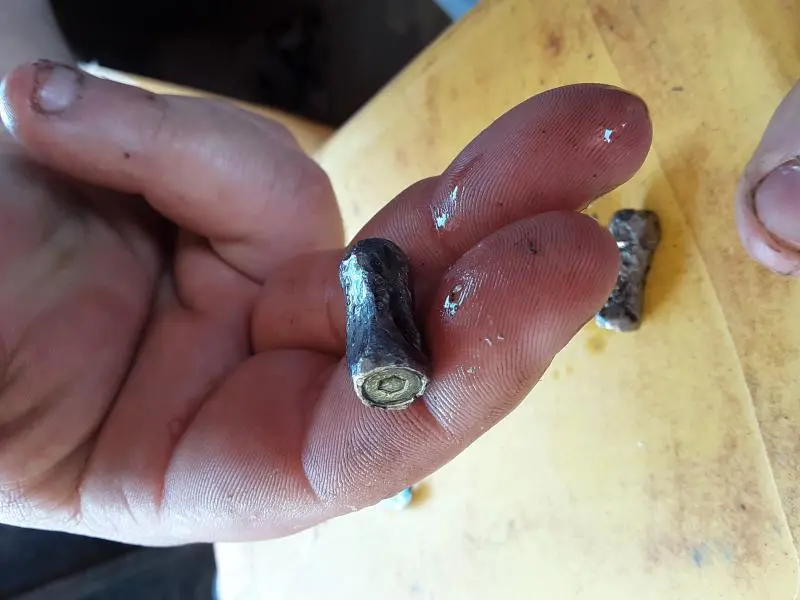

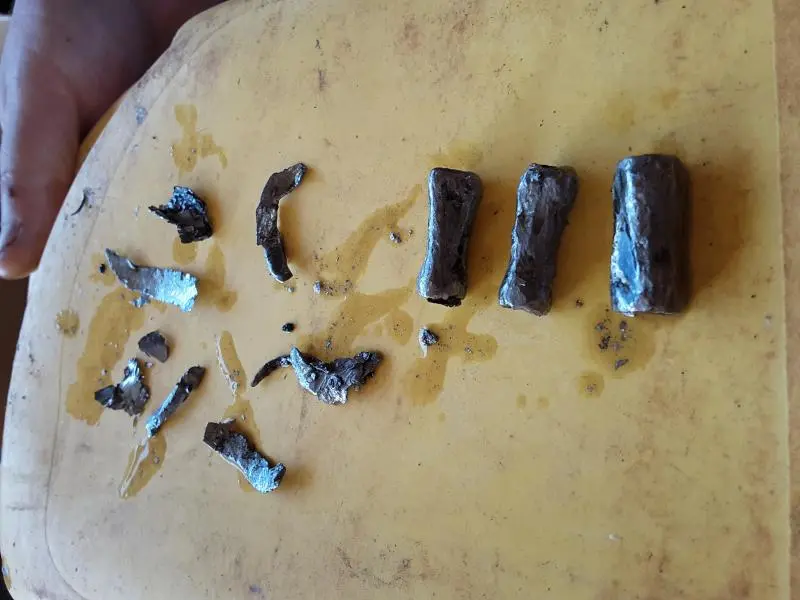

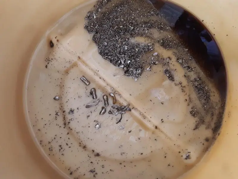

got it home and drained the fluids this morning, trans and final drives was both clean and nothing out of the ordinary. the bevel gear department was another story. alot of metal and a few round metal chunks, a roller bearing perhaps? what do yall think and what would be my next step to figuring out the exact problem? pull the weight off the back and look into the inspection

Glum
Send a private message to Glum
Posts: 264
Reply to wlf89:
[attachment=60049]20200811_102039.jpg[/attachment][attachment=60050]20200811_102146.jpg[/attachment][attachment=60051]20200811_102159.jpg[/attachment]
No getting away from it, remove fuel tank and covers and get the bevel gear and steering clutches out. Then you can start to assess the damage.

Posts: 7,246
Thank you received: 60
Reply to Glum:
If you're extremely lucky, it might just be bearings but I'd suspect the gears will be damaged too

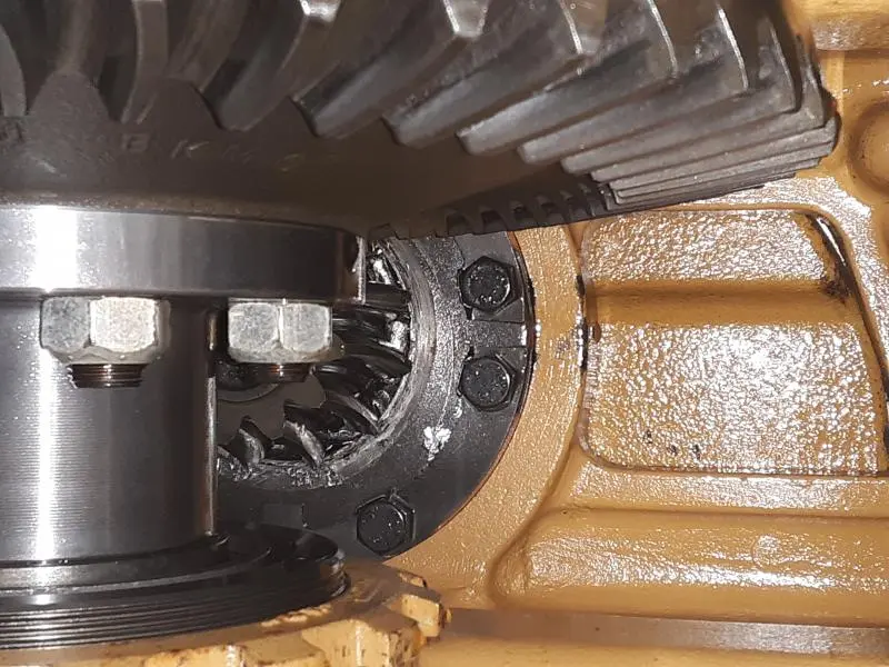

i got the weight and inspection covers off and looks like its the output shaft bearings on the transmission. hard to see the gears but looks like the pinion gear might have some damage but looks like the ring gear is still good im hoping. [attachment=60055]20200811_160625.jpg[/attachment]

anyone have any leads on where i might find a pinion? i can find the ring gear but no pinion. part number is 4s8715 thanks
