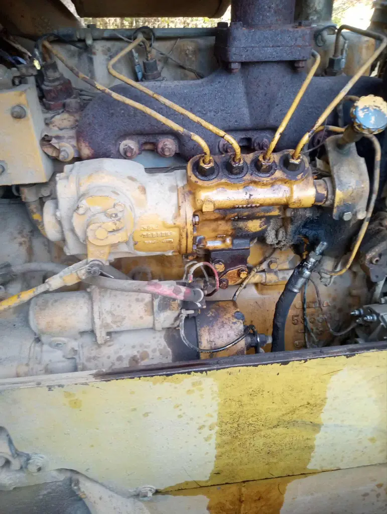

if i take the rear cover off the governor housing can i see the rack then? will the cover come right off after unbolting or is there linkages or springs gonna go flying out?
this is the only pic of the pump i have on my phone

Posts: 6,882
Thank you received: 66
Hi,wlf89.
I'll hafta leave it to somebody else to answer that as I am not a mechanic and have never been inside one of those governors. Hopefully, somebody with more knowledge than I have will chime in here shortly.
