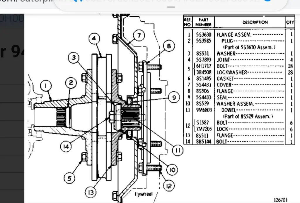

There are three different style couplings for the 941, One includes a center bolt.

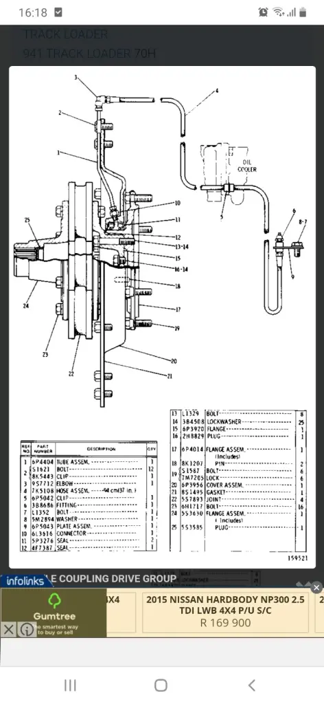

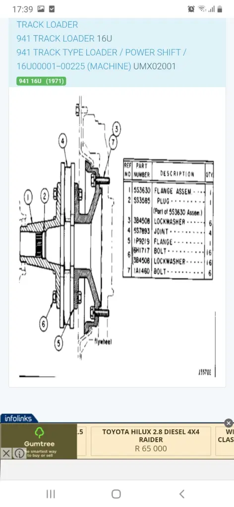

Here is what OM is talking about.
I've not seen the centre bolt version myself.
[attachment=60791]Screenshot_20201010-161801_Chrome.jpg[/attachment] [attachment=60792]Screenshot_20201010-173921_Chrome.jpg[/attachment] [attachment=60793]20201010_174646.jpg[/attachment]
