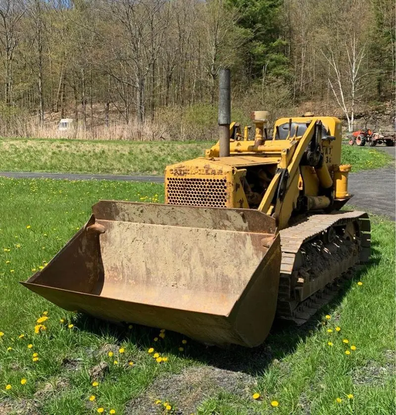

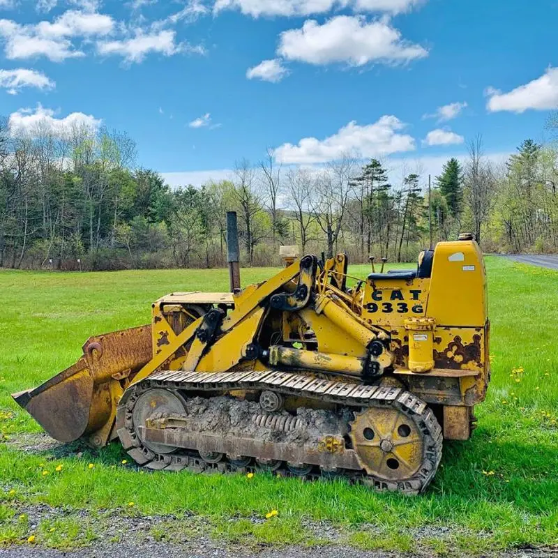

Looking at one here real soon. Price is right so worth a look. Owner says it has steering issues. Im figuring clutches and brakes likely? Im a decent mechanic, owned many older machines but never a 933 (that will be kinda newer for me) How is the job of replacing the steering clutches and brakes on a 933? Scale of 1-10...10 being better to scrap..))
Thanks for the input!
Frank
[attachment=58954]9332.jpg[/attachment][attachment=58955]93322.jpg[/attachment]

That unit looks pretty clean and straight. Unfortunately loaders in general are about the most difficult to get access for working on them.

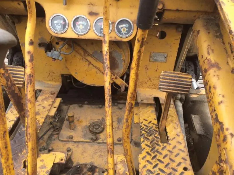

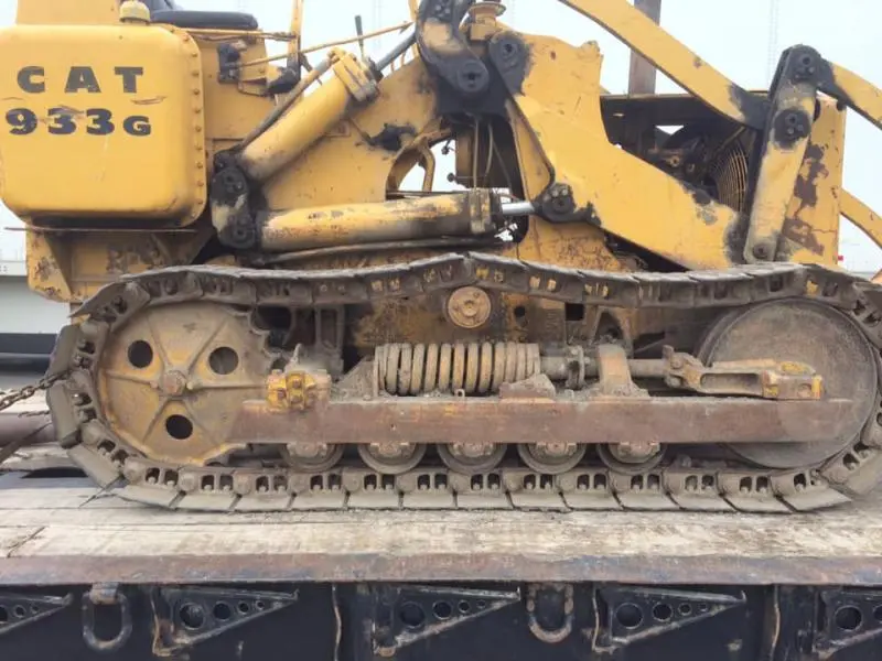

[attachment=59105]ch1.jpg[/attachment][attachment=59106]ch2.jpg[/attachment][attachment=59107]ch3.jpg[/attachment][attachment=59108]ch4.jpg[/attachment]
Foot brakes feel a little mushy...and they are slipping..I need to wash/drain the clutch/brake cavaties of oil I figure. Probably not been done in a LOooong time.
The Goy I bought it from, nice guy, but he said he dumped 2 gallons of wd 40 in..?? he couldnt remember. Said he was told to that this might free the clutch..UGH...So I need to change the trans fluid and the clutch oil. To be sure...lol
The right side clutch is stuck engaged. ((( Any suggestions? I already held the lever back and pushed into a pile of shale near full throttle a couple time..still stuck
A few electrical things to tidy up but this girl sure is pretty....

My observation from the photo's is that it was cared for based on the black grease all around the linkage joints. The owner actually greased it! So many machines today seem to be lacking Grease!
