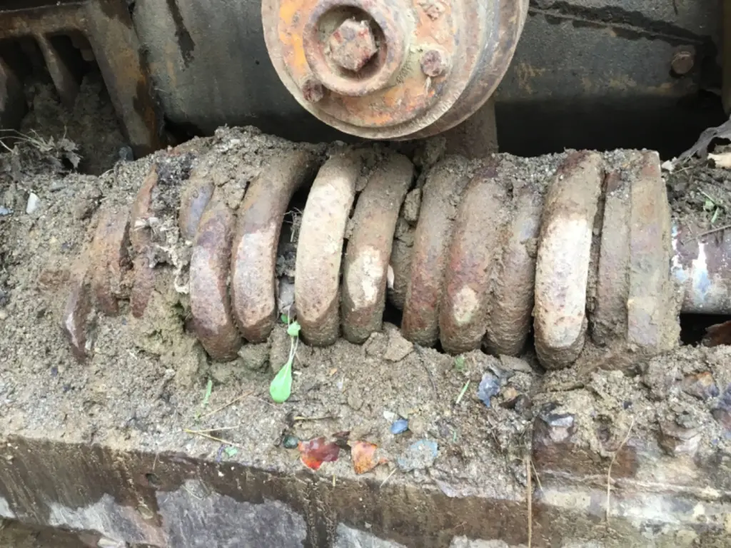

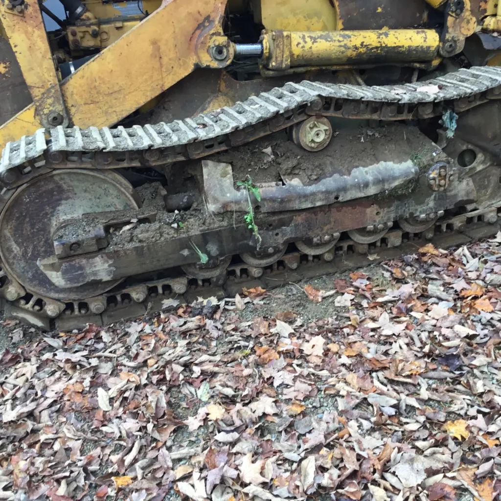

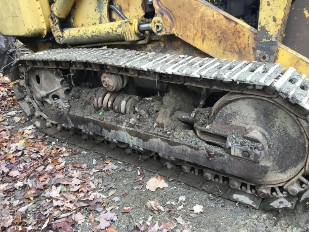

one concern I have is the difference in the way the tracks lye: one appears taught while the other looks “loose”? Also one of the track springs may be broken.
My question is twofold: is there anything in the photos that require immediate attention/fixing? What’s the likelihood that I could use this machine “as is” for small projects?

there are adjusters that allow adjustment of the track tension--it appears one track is too loose and the other is too tight-there is a spec on the proper amount of sag--it appears you have a broken recoil spring==-if you are careful not to hit the idler into anything you can run it the way it is--I had 3 broken rings in one spring for over 20 years before it let go---WARNING--springs have a tremendous amount of potential energy so best repaired by someone familiar with them--my 941B took 14 tons of compression on the new spring

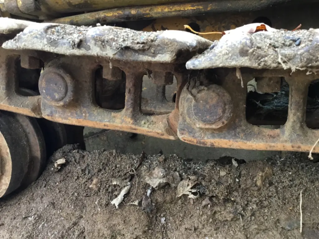

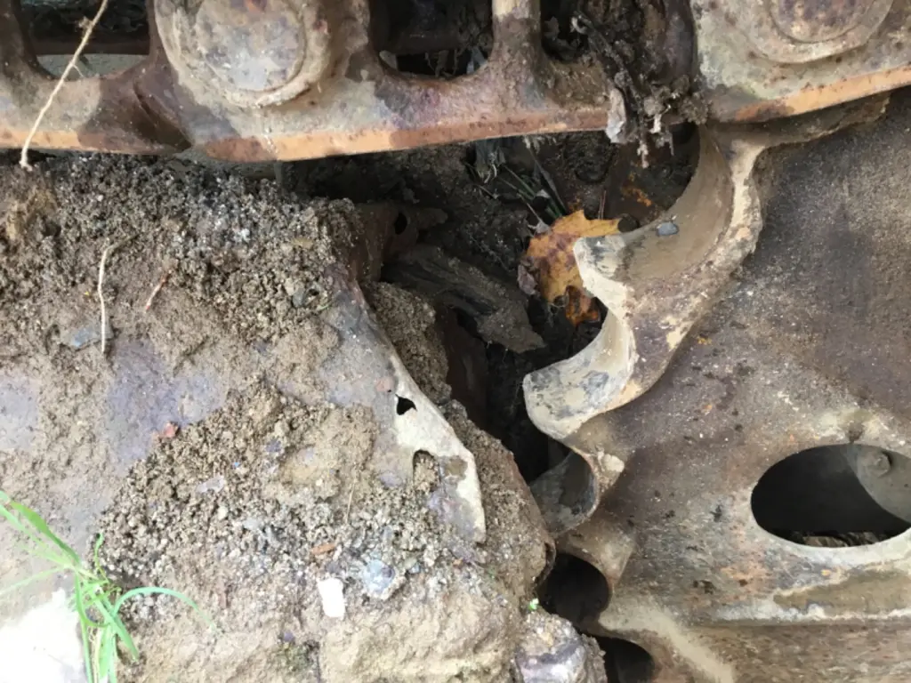

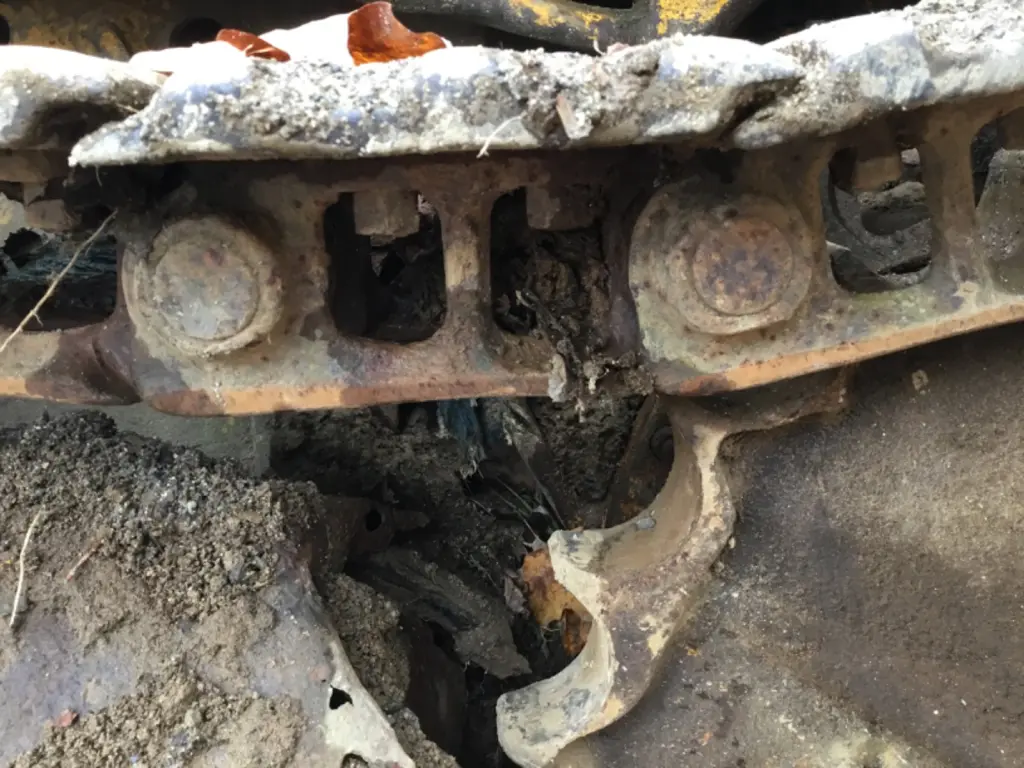

Could someone comment on the condition of the track chainsand sprockets? Thanks!

The undercarriage looks to be good enough for your stated purpose for a long time. The bottom rollers are not hitting the track pin bosses, the sprockets aren't worn too much and the idlers are worn thin but they should last a while.
The broken recoil springs can probably last if you avoid shock loads and sharp turns.
