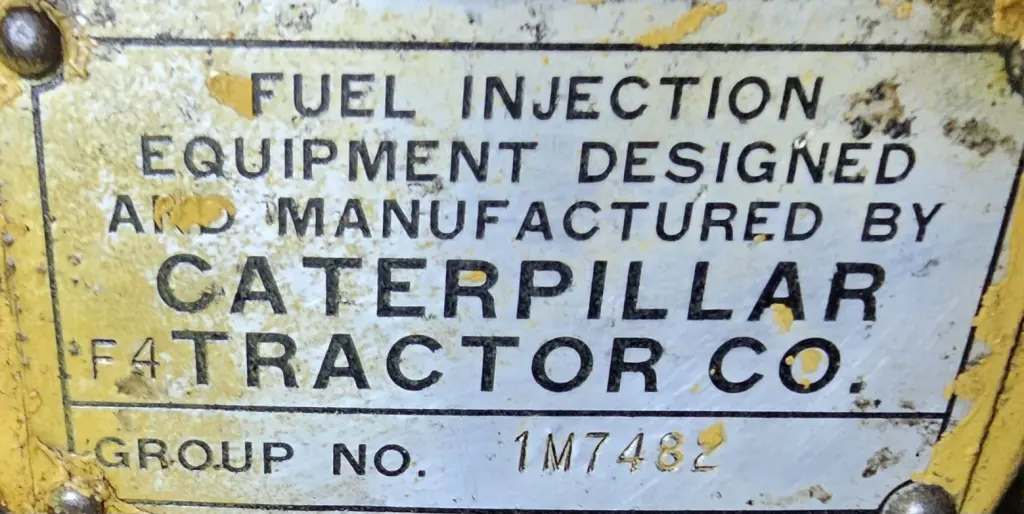

 [attachment=73811]F4C2C139-248D-4D41-9244-983A2B6C68FA.jpeg[/attachment]I'm trying to remove the fuel injection pump off a 933 Traxcavator.  Not sure what engine is in it.  It has the fuel pump and filter on RH side of machine.  The is a tag on Injection pump that says Group 1M7482.  There is also a F4 stamped on the plate.

That would be a D311H or D320 engine. Injection pump removal is pretty straight forward once the mounting bolts are removed. What seems to be the problem?
