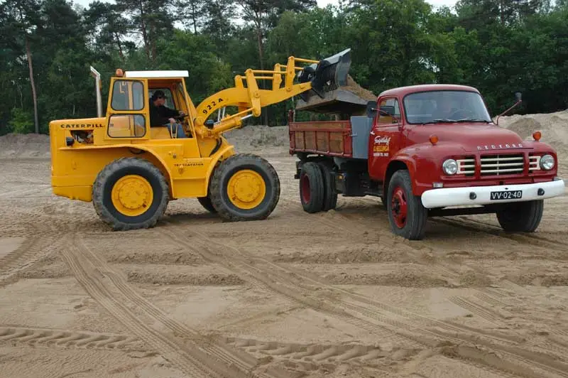

Hi,
the 922A 59A series were powered by a 4"x 5" D320 turbochatrged engine rated at 80 fhp or 105 max hp.
Max governed speed is 2535 RPM.
Grom what i have the liftin capacity is about 12000 lbd over the 1st ft of the ground going down to 7000 lbs at full lift.
weight is approx 15970 lbs according my 1960 brochure.
I own a 1962 one serial 59a1987 and like the sound of the original engine better than any other.
If you need more info, please let me know.
Nico
