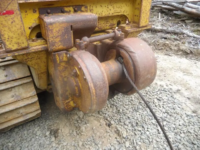

This winch is easy enough to use. With the control handle in one position, the cable just continues to slowly wind on the reel non stop.
With the 50 feet of cable that was on the winch, it would never bind up, just bang the chokers as they slowly rotated around and around the drum.
Now the winch will get 100 foot of new 3/4 cable with the same 4 choker set up. Lack of a fairling to speak of might be a PITA.

That looks to be a 19Exxxx s/n model. The parts book doesn't show a fairlead option.
