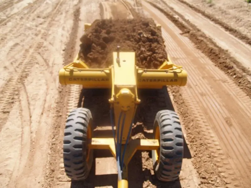

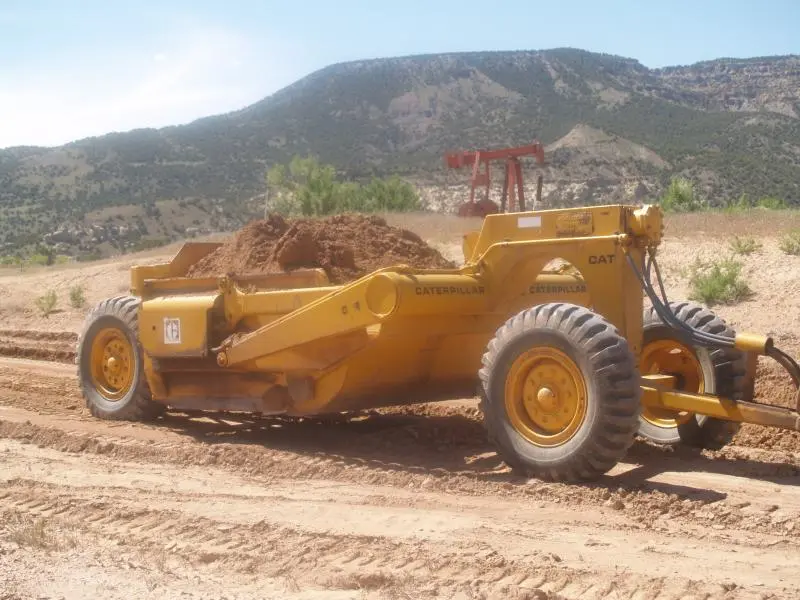

Never posted photos before, hopefully this will work, if photos don't come up, may have to enlist some help from daughter, be patient, will keep trying,also Scraper is coming up for sale at auction Sept 10, 2011, please see new post on For Sale /wanted site, Thanks

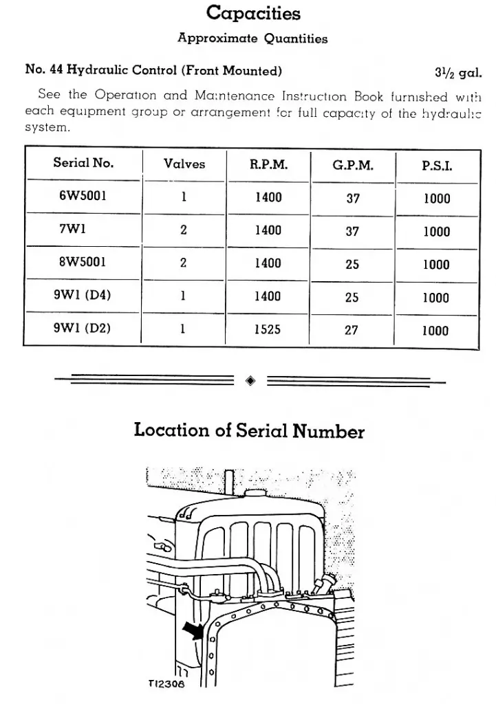

Got a couple of questions maybe you can answer......not sale related.
I assume you've been pulling your #40 with a D4D. Questions are whether you have been using a surge tank with the hydraulic unit and what size GPM pump are you using. Thanks and good luck with the sale, looks to be a fine unit.

Hi Old Magnet, I knew someone would bring up that question, I'm not using any extra surge tank. I just tried it with out one and it worked fine and I've used it a lot. The 40 did most of my 1000 ft air strip and there was a 7 ft cut in the middle and a couple of 4 ft fills. I'm pulling it with my 82j and I know that pump is worn out, have not pulled with either of the 83j tractors, all have 3304s. I have not learned yet how to identify the different GPM pumps and between pumps on machines and used spares I have about 7 pumps. I still need to up grad the pump on the 82j as I'm still keeping one of my two 40 scrapers.

Those are most likely 35 to 37 GPM pumps, depending on model.
If it works ok I guess that's the answer.
There doesn't seem to be any info about #40 to D4D application.
Closest thing I could find is a dozer, tilt, backhoe combination which utilizes a surge tank.

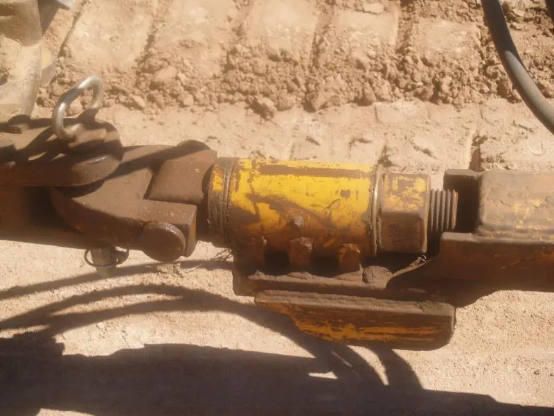

Thanks Old Magnet for more info, what is the smallest to the largest gpm pumps available and are they just marked with a part number or are they stamped as to gpm? I've never noticed a surge tank in any of my D model parts books but I'll go back through them. Also, take a good look at the hitch on my 40, its twice as heavy as my secound machine but it looks like genuine cat. Somewhere in the past someone mentioned an optional heavy hitch, is this true? thanks

Hi Team,
from my OMI for the 44 Hyd. Control, Form No 31677-1, Dated 10-56, this book has a Factory sticker over the printed S/No position with 22D1-up on it. However the specs are for W S/No units.
Scanned is the pump outputs for the respective S/No Control Units.
Also scanned are the notes for the Surge Tank Applications.
Hope this helps.
