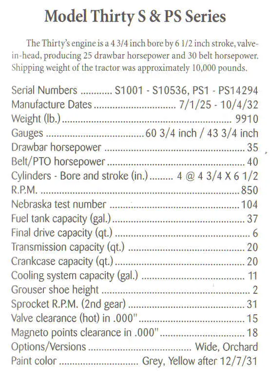

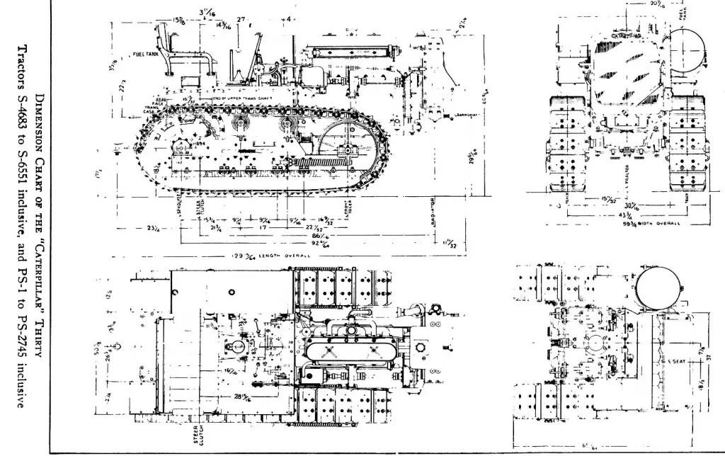

I’m looking for some information on a caterpillar 30 orchard it’s a 1930 I was wondering what the dimensions of the tractor are length width and a possible weight i’m not sure What’s the width on the track Pads are I know that makes a difference in weight any help would be greatly appreciated thank you

Hi,
do not have orchard 30 dimensions, but the scans below may help--the detailed outline is readable when printed I have been told.
Hope these help.
Your Orchard will be slightly longer due to the low rear position seat.

Perfect thank you very much I’m glad I brought my longer heavier trailer to pick up my new orchard 30
