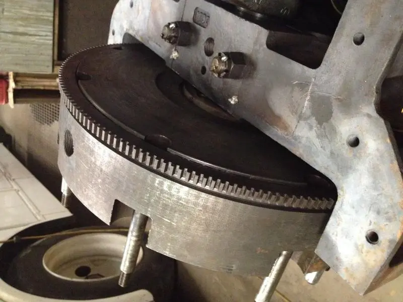

Hi chugwater crawlers, can you tell me how thick the adapter plate was and if the hole for the starter was in the middle, is it just big enough for the starter nose? Also do you have any dimensions for the machining of the flywheel, diameter, depth. There looks like there is a recess for the starter gear if it goes pass the ring gear when it engages. How much of a squeeze for the ring gear, .005, .010? The ring gear is .375 thick. How far on the flywheel is the ring gear, .375 or more, .500? Thanks Guy
Fri, Sep 4, 2015 8:41 PM
chugwater crawlers
Posts: 394
Reply to guy:
The adapter plate is 5/8 thick. The two smaller holes are threaded to hold the starter to the plate. The adapter starter hole matches the hole on the tractor. I have attached a photo of the ring gear installed on another 22 to help you out.
I don't have the other measurements since I did not do the actual machining. I called the person that machined it. He said the squeeze is .010-.012. He could not find the other measurements when I called but said he will look for them for you. Chad Enyeart has another flywheel that I had machined with a gear on it sitting at his shop. He may be able to help. He was also looking at having some adapters made for that conversion.
