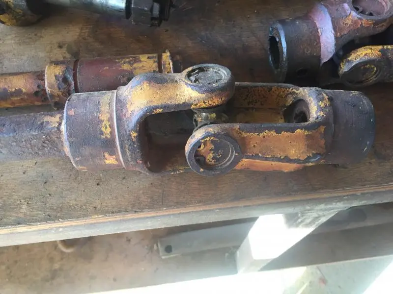

Hello all ,
I’m chasing the part numbers for both yoke’s and universal for my 212 grader in the photo below,
Mine is a 212 grader made in Aust serial number 95C135,
The parts book I got is for a 9T and has the old Uni in it with a Pin and my grader has the later ones with the circlip ,
I came across a S8T Grader and measured the yoke and found it to be the same as mine ,
The bloke didn’t have the parts book for his S8T machine ,
So I was hoping some one out there might have a S8T parts book and could tell me the number for the Yokes and Universal ,
I think all the uni’s and yokes from the power control box are the same on the machine , this one I am cashing is for the circle reverse drive shaft near the circle joey box,
Thanks in advance
Danny

If you measure it, might cross to a good Spicer number.

4f3506 out of the 8t1-up book. I agree with Steven , measure and find spicer. 4f3506 is the u joint but does not exist in parts search. Yoke? round shaft? square shaft? round hole for a pin? to pin to shaft. Circle rev shaft does not show the u joint # in my book. Just a detail of the join on steering shaft.

For an 8T14782-up the spider & bearing (u-joint w/circlip) for the control shaft is a 2D2978 or aftermarket UJ983
The yoke for the circle reverse mech. (fork) is a 1D3996.
Thanks everybody , great help
