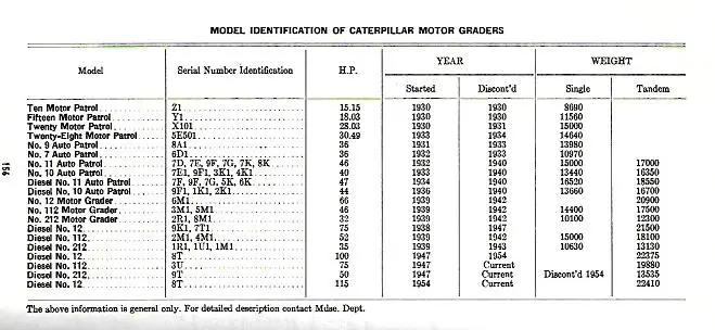

Hi Team,
scan below from my Earthmoving Guide To Profit (Early Version of Performance Handbook) Fourth Edition, Form No 717-31397, Dated 1955.
Hope this Data is more correct than other forms.
Sun, Dec 16, 2018 5:54 AM
