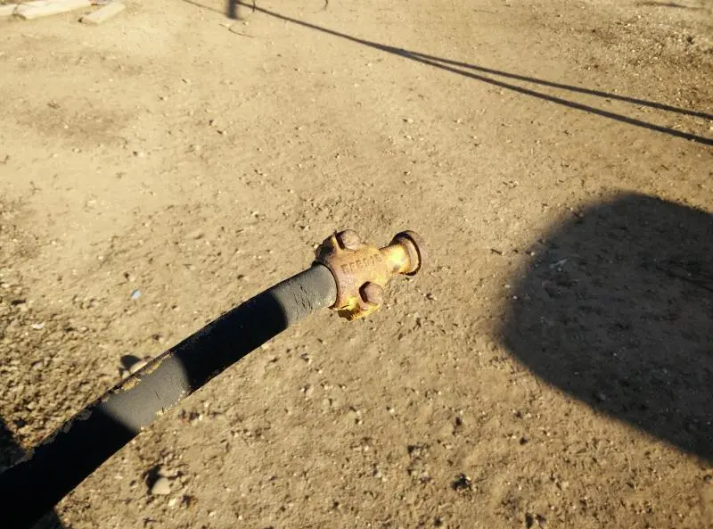

Is this the fitting you are looking for? This was from a late 5u with a toolbar blade.I only have this one not 2 .So if the ordered part doesn't work this one is available.
I think this is the same hose ends I have on my D6 I have bought hose and used the ends to make new ones .. I don't have any extra but should be common to lots of equipment ..
The cat dealer should have these as they were used on the earlier cat excavators, 225,235,245, and 215 as well as other machines built into the 1980's
