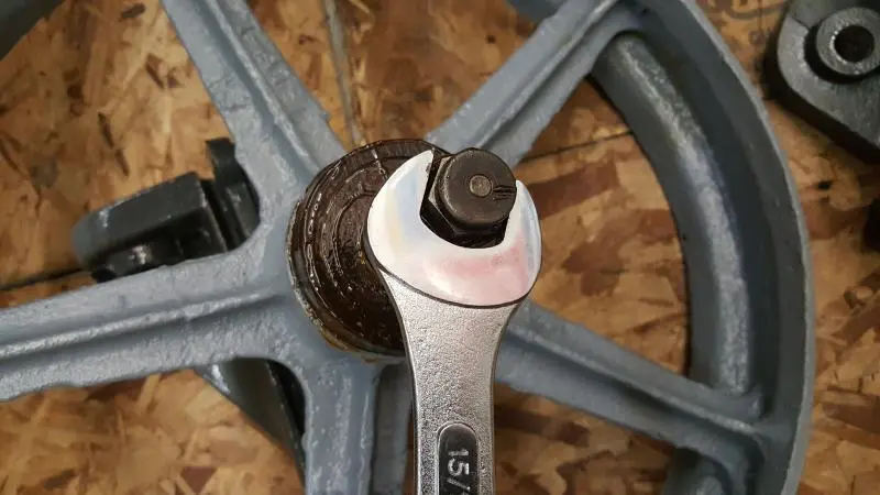

If you don't find any fittings this week let me know. There were a few left at the hydraulic shop I got the the applicator tip at. Post a picture of the one you have.[attachment=39162]20160517_151656.jpg[/attachment]
