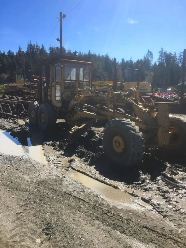

I'm looking at buying a cat 14 d but it is missing the brake master cylinder. Are these a common part or are they something special? Also the exhaust manifold is broken. The mount for the elbow after the turbo is broken off and there is a hole in the manifold. Is this something easily brazed back together or better off replacing.

Pretty much any brake master cylinder of sufficient capacity would do the job but you may be able to pick up the original unit from Florin Tractors at Sacramento, CA..
https://www.florintractor.com/default.htm
They may also have the manifold and other exhaust parts that you mention but I suspect that a welder worth his salt would be able to repair both of those parts.
