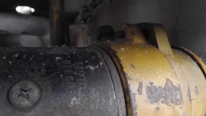

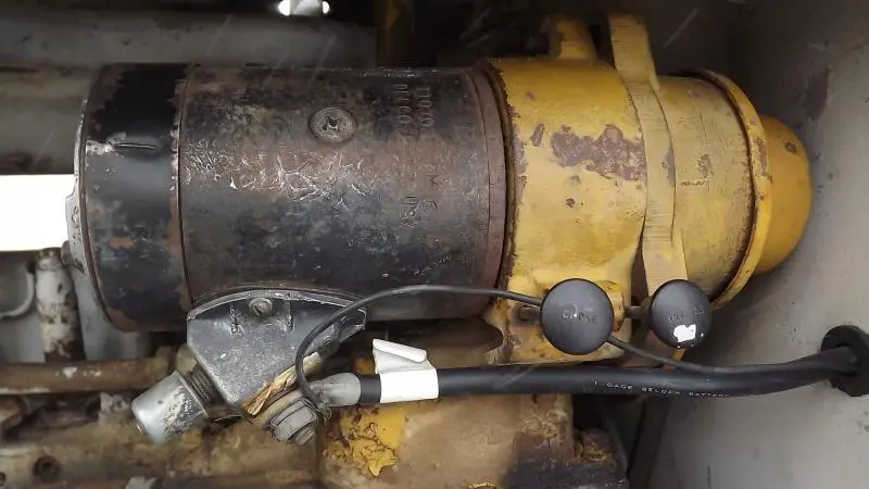

I know this make me look dumb but I don want to spend anymore time than necessary outside -13 Degrees. How do i remove the pony starter on my pony motor 6B2861, 1942 Cat 12 Grader. is it the friction bolt on top?[attachment=56463]DSCF3558.jpg[/attachment][attachment=56463]DSCF3558.jpg[/attachment][attachment=56464]DSCF3562.jpg[/attachment][attachment=56464]DSCF3562.jpg[/attachment]

Should be a 5/8" bolt on top of the yellow bracket with a lock nut. Turn it out and starter should slide out.
Thank you!!!

It may also be rusted into the housing. Spray it down with PB Blaster the day before.
