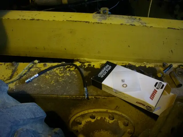

on buddy barry's cat 12 grader which i think is a 99 serial number (the bigger one) we need a flex brake line. anyone got a part number so we can order from napa????

King - You wouldn't believe this .. but I haven't got anything as modern as a 99E parts catalog .. so I looked up the old 9K catalog .. got the P/N .. and then checked the NPR, just on a hunch that hose never changed in nearly 30 years .. and I was right!! ..
The hose P/N is 4B8761 .. and if you keep a spare on hand, it will fit nearly every rigid frame Cat grader built, that's fitted with brakes, from 1938 to the early 1970's .. 😮

KoO Well I searched that CAT number on the Napa web site and no good, but I did run it on the CAT part number search and crossed it over to a Napa number UP 4900 here is it's description.
Brake Hose End Type : 7/16" - 20 & 7/16" - 24 Internal.
Brake Hose Gasket Part # : 1243
Brake Hose Length : 17.688"
Caution Statement : Do Not Use w/ Petroleum-Based Fluids - Designed Only For Use w/ DOT Approved Silicone- Or Glycol-Based Brake Fluids.
Hope this helps. Here is a pic.

thansk guys, the telephones are up and working and i got a hold of buddy barry 1200 kms in the south and he will swing by napa and pick up 2 brake lines. when he returns to the great white north is when we will find out if they fit. if not i'll have new brake hoses for my monster truck, LOL.

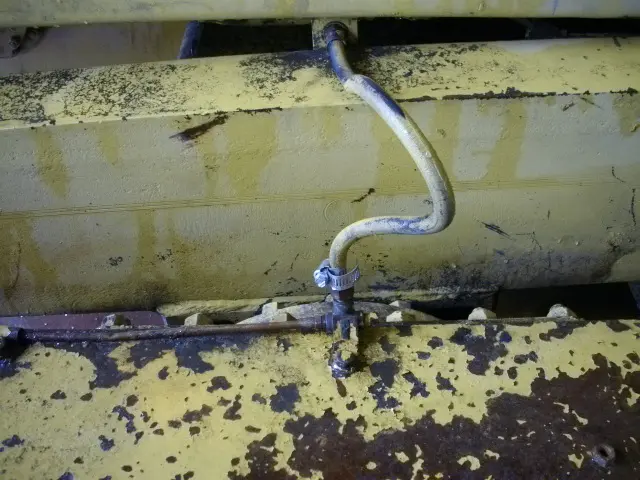

buddy barry hand delivered the brake hoses are bouncing over the so called road to the south in the pouring rain. i put them on and now i have to wait for the fitting for the new steel brake lines.
that is way buddy barry has a 3 bay shop that fits 8 items in so we can take one apart and then move on to the next one as we "wait" for the parts to come in. a big thansk to you guys on the internet because we are getting the correct parts instead of the wrong parts.
