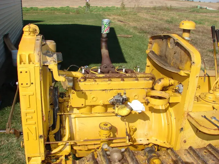

The governor arm on my 10 seems dangerously close to the fan blades. The arm is held to location by a keyway, so can't just be loosened and backed off a bit. Is this a normal situation, or is there another adjusting place? Many thanks, Robert

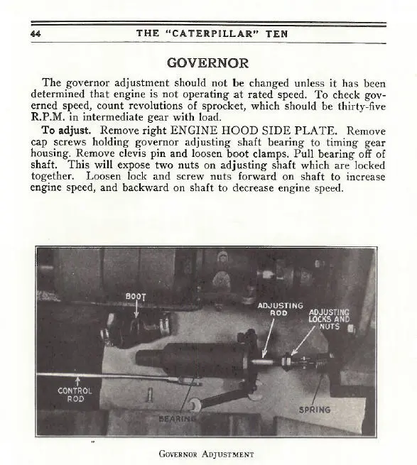

Here is a pic of where mine sits when the engine is off. Also, here is the governor adjusting procedure from the operator's manual.
[attachment=13347]DSC03711a.JPG[/attachment]
[attachment=13348]ten_governor.jpg[/attachment]

Dave,
Thanks a million.
