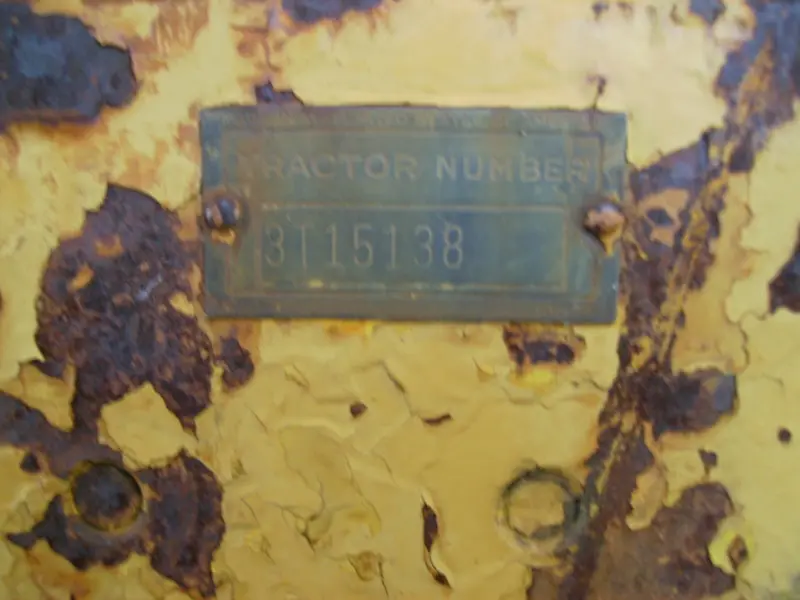

OM thanks my #3t15138
That's a 1951 model....looks good....fortunate to have hydraulic hard nose dozer.
Original carb is a Cat #7F5546.......Zenith model 22AX8
Others will interchange but you may have to be specific with model when it comes to parts.
I believe carb kit sources are listed in the "parts sources" sticky.
I can post parts breakdown if you need.
