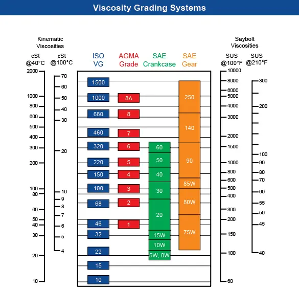

I use that stuff in my wheeled tractors where the trans and hydraulic system use the same oil--but in my dozers i use hydraulic oil in the hydraulic system--R&O aw 46 which i get in Sams club--I think TSC has a standard hydraulic oil also
[attachment=58068]Viscosity-Chart.jpg[/attachment]

Original spec for hydraulic system is SAE10W. Closer to a ISO 32. ISO 46 will be slow to pump at cold temperatures.

Thanks guys! I was just reading another forum of a guy having problems with too thick of an oil in the hydraulics. I dont want to deal with that. I think im going to take it back and get iso 32. Rural King carries it cheap.
