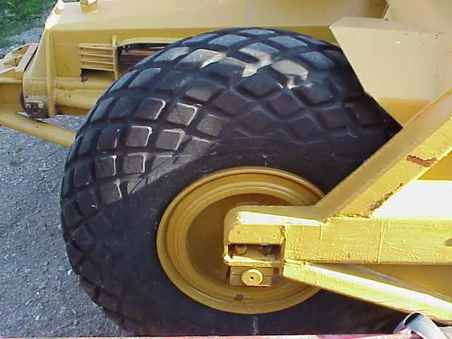

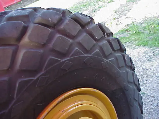

Now have sandblasted the rims and put the tires in without tube !!😉
Here some pictures from the new and the old tires.
Iam still looking for 2 1400-21 tires.
