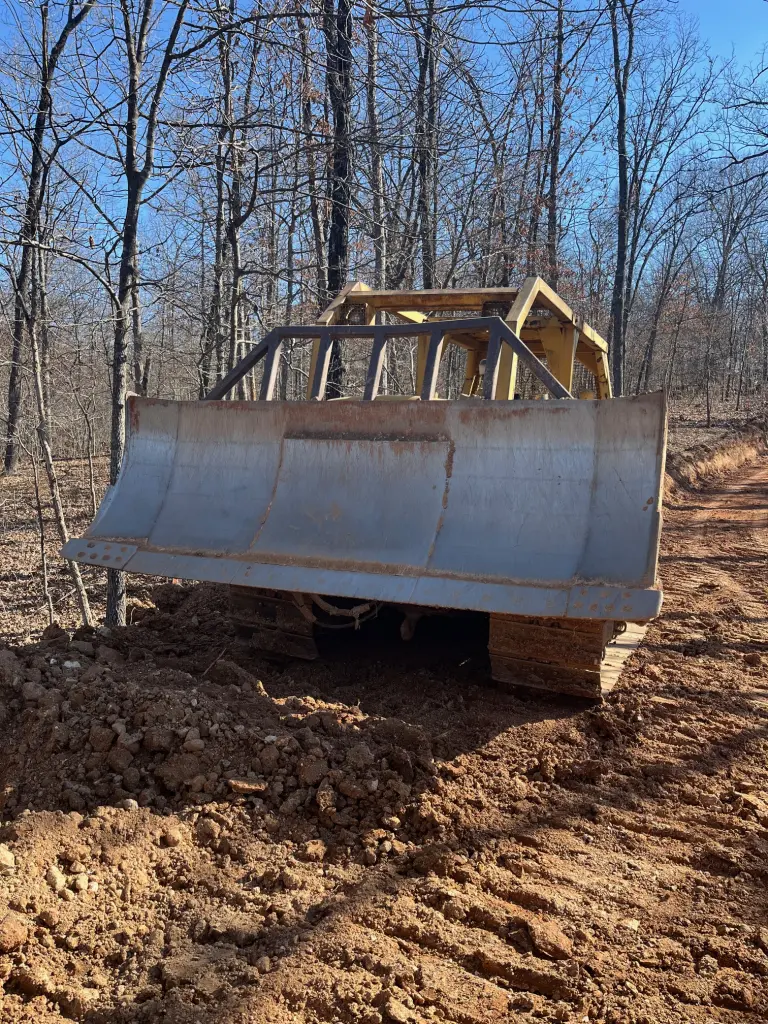

Millitary D7E S/N 75e540 , we are struggling to come up with part # for edges and end bits , Blade # 5s 77E54 , end bits are on a angle and are angle cut to fit up to the center edge , any help would be appreciated .

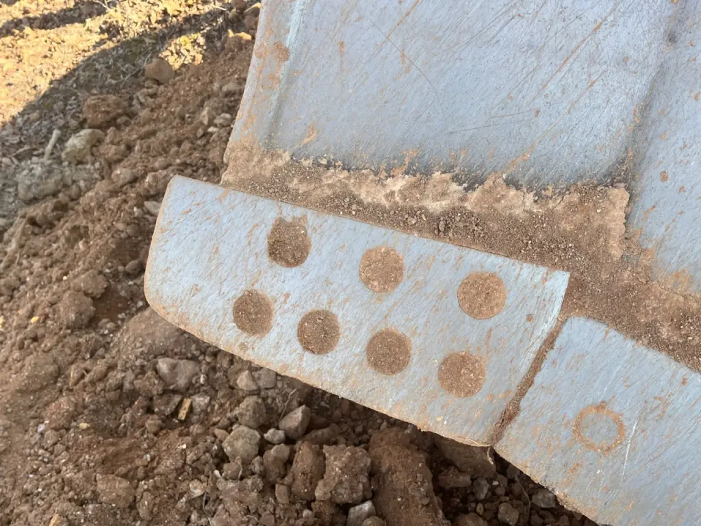

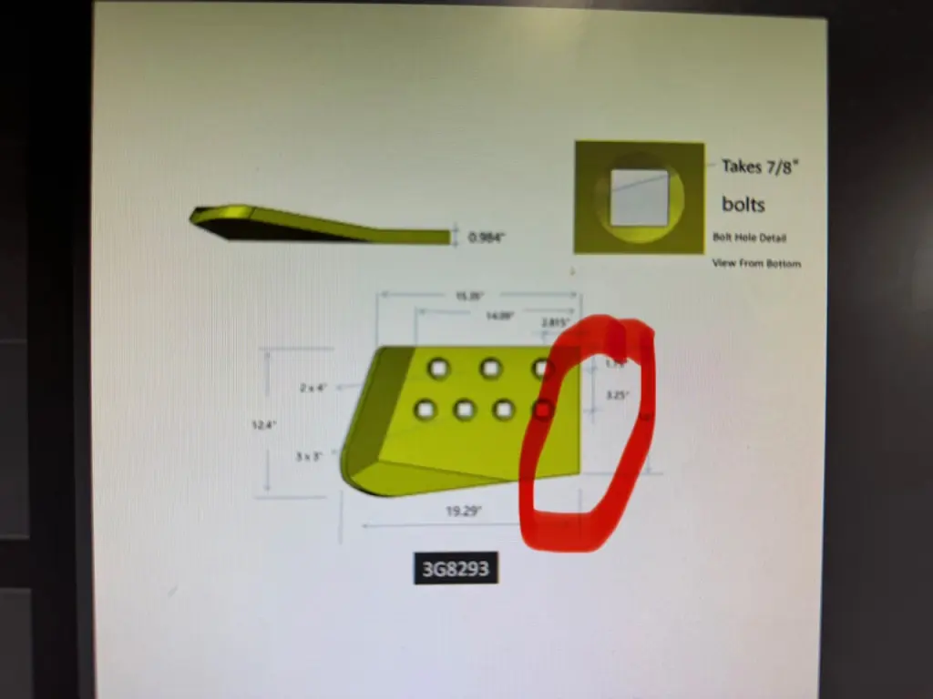

So here is are problem area which i circled in red, will not fit with out cutting , is the blade modified ? , or what is going on?

No, the blade is NOT modified. It is what is known as a 'semi-U blade' and there ARE corner tips made to fit straight on to it. You just need to get the right ones for it.
As I mentioned in my earlier reply, any good ground engaging tools/cutting edge supplier should be able to match them if you give them the serial # of the blade. Heck, you could even make a cardboard template of one of them to take in with you. You should only need one template 'cos the other corner tip will be the flip side of your template.

Must be a Military thing. My literature (extensive) is not showing a semi-U blade for that tractor. May have to trim the corner on the standard end bit.
When I do look for a SU end bit they come in six bolt mounting.
The 7U has a seven bolt mounting but is no longer listed in my 1989 catalog or One Safe Source 2004-2005 listing.

Try 9W6198-9 general duty or 4T6505-6 for utility bits.

With the blade S/n it is coming up with ones that are not cut .
