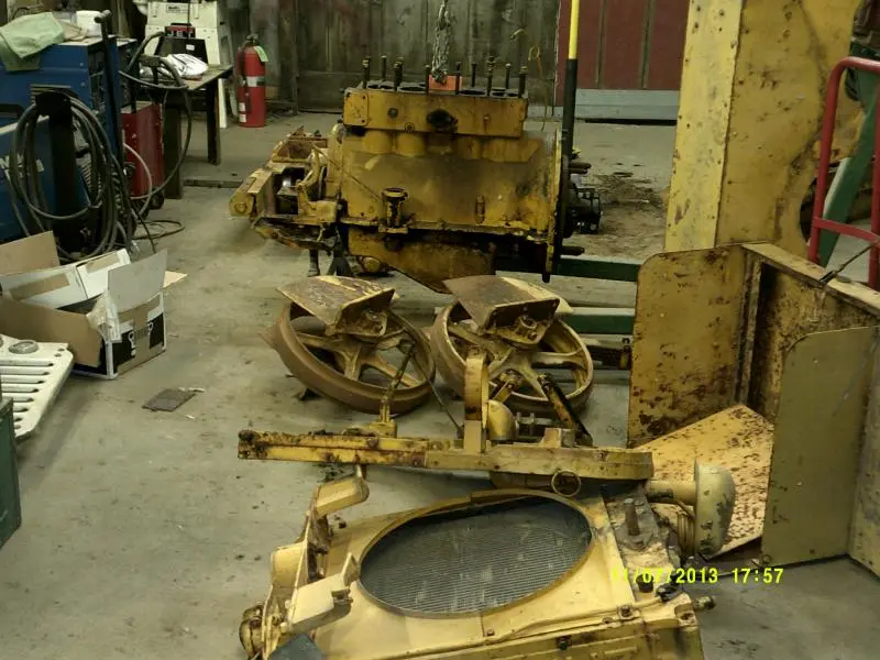

12 hours ago, this was a tractor:
[attachment=20468]DSCF0029.jpg[/attachment]

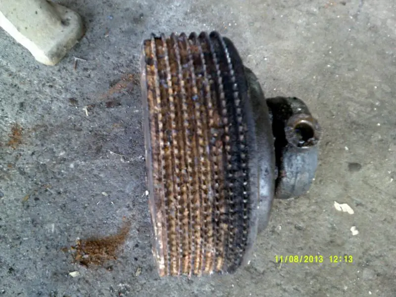

Steering clutches very rusty:
[attachment=20469]DSCF0070.jpg[/attachment]

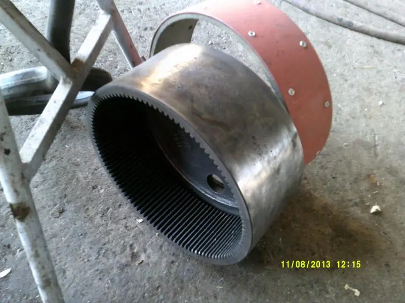

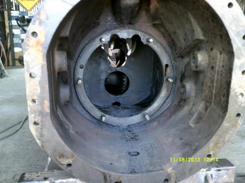

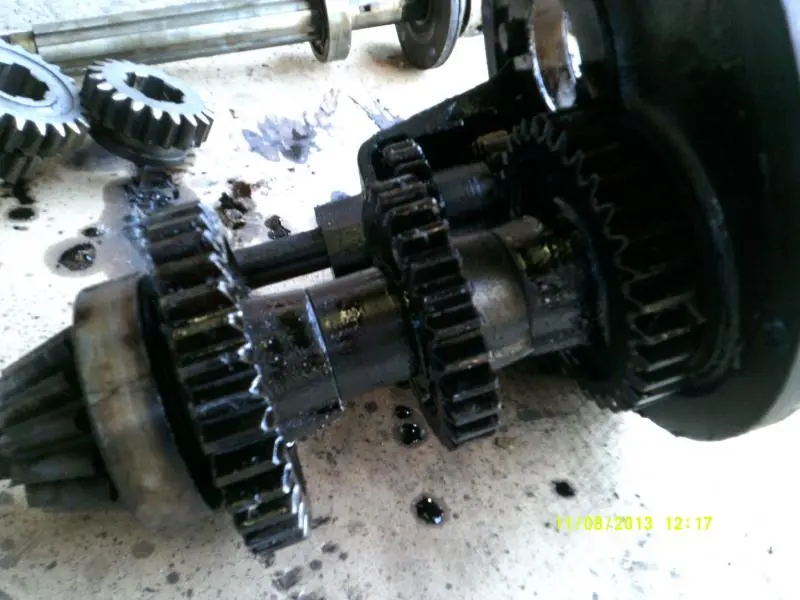

Transmission housing and relined brake bands:
[attachment=20470]DSCF0074.jpg[/attachment][attachment=20471]DSCF0079.jpg[/attachment][attachment=20472]DSCF0086.jpg[/attachment]
Received gasket set today with new input shaft seal and bellows seal cork gaskets and felts. Hopefully they will work good (looks very nice). We are hoping to use the steering clutches from the parts tractor, as the ones in the orchard tractor were/are very rusty and swelled. I have called around to find someone who has relined these 15's or 22's in the past for steering clutches, but no luck yet. Does anyone here know the clutch pack thickness measurements for new thickness and 100% worn out?
