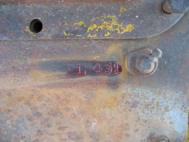

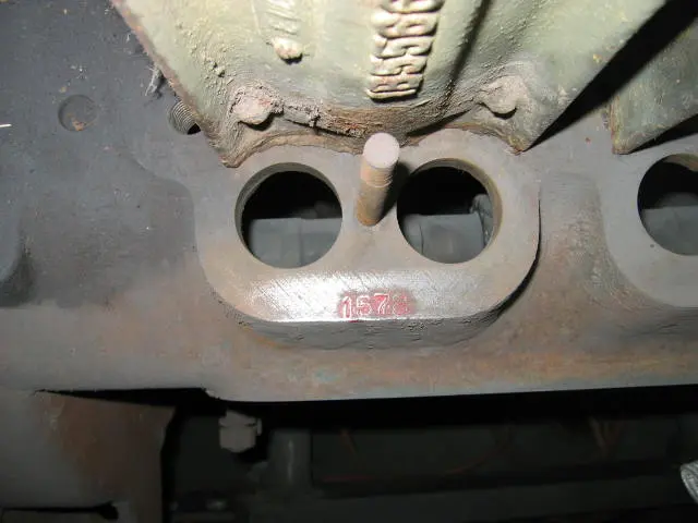

HI There is a second place the number might be. It is on the crankcase by the lifters for cylinder #4. I am going to try and include a picture. Also I have included a picture of where it is on the trani case.

Thanks mucho! I found the S/N in both places, by the valve lifters on cyl 4 and on the transmission housing. The number was 4085 which places it as manufactured in Peoria. I saw a list at Tulare of the dates of manufacture broken down by serial nembers. Does anybody have that list for the big cat 20?
