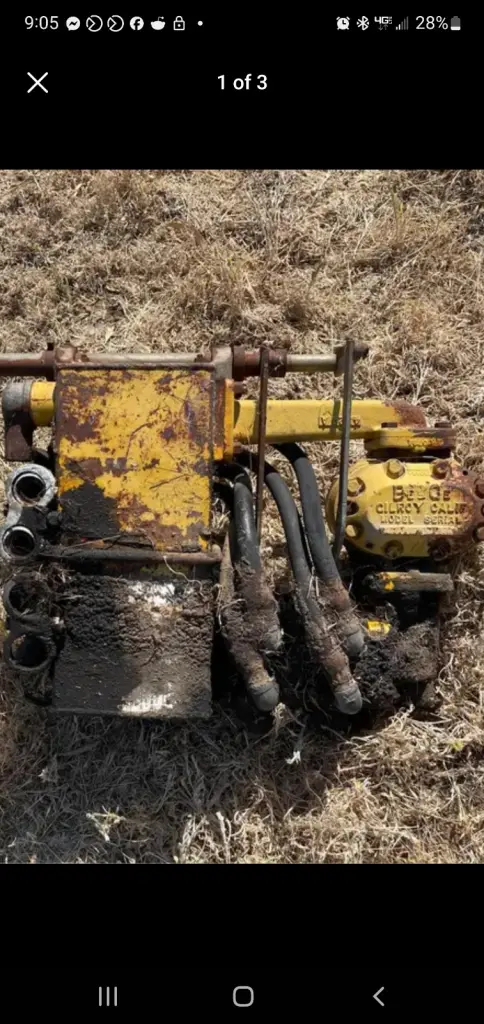

https://www.facebook.com/groups/agequipmentclassifieds/permalink/8110219575695170/?mibextid=dXMIcH
Well after reading through your info I am not sure when I would have time.. If anyone is curious the guys asking 150. Remove link if not allowed.
