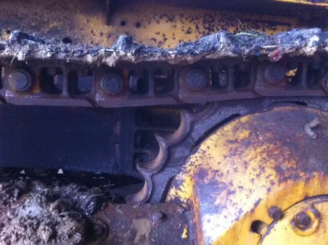

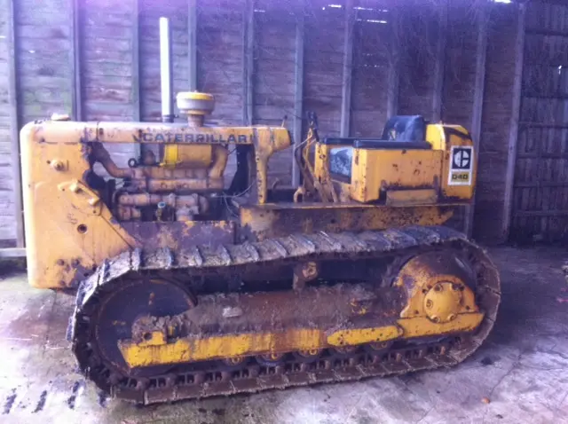

Thanks Jim, turned out it would not start due to having run out of "go go" juice!!! Arrived in the yard this morn, dragged it off the low loader put some juice in her, bled and away we went, batteries seem fine although suspect the Bendix may need some lubrication. All works as it should, having just tracked it the 1.5 miles down the farm track.
Serial number is 60jJ1134, engine number the same, trans type 4K5035.
What workshop manual/parts manual should I get as there seem a number of different ones for the D4d?
A couple of pics, I suspect it had a dozer blade fitted at one time but no longer.
[attachment=20965]11512200253_636b4ba4ec_z.jpg[/attachment]
[attachment=20966]11512203143_2971ec4342_z.jpg[/attachment]

Nice looking machine.
It may not have had a dozer attachment. A hydraulic tank would typically have been installed between the engine and instrument panel. Also, trunion balls for the blade arms would have been bolted to the outside of the roller frame just ahead of the sprocket.
A lot of this size machine with direct drive transmissions did primarily drawbar work in agriculture and such.

Jim,
yes it has the lumps of steel bolted in front of the sprockets, I suspect the trunion balls were gassed of, there is also evidence of holes were the lever would have come through the right side below the battery box (blade control I guess?) I need to do a little more research.
Merry Christmas
