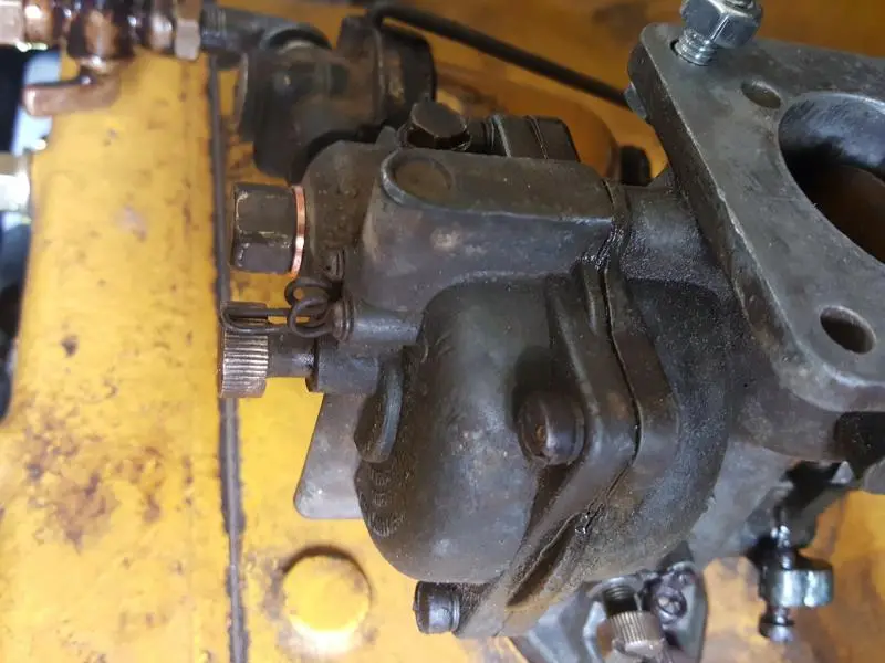

i was able to cast one top of the ensign carb for my TEN that had a Original broken top that happans a lot if the top screws are tightened to much with too thick seals of the centre shaft , or if the intake of the carb is tightened to much if its leaking.
i cast it , and put it in a lathe to make it flat and machined all holes it it. tested it and my ten runs good on it!
it would be realy awsome that there would complete new carbs made !!
i have 2 CAT Fifteens that have now a solex carb that was used a lot here as "beter" option after years of operation for the Original carb.
