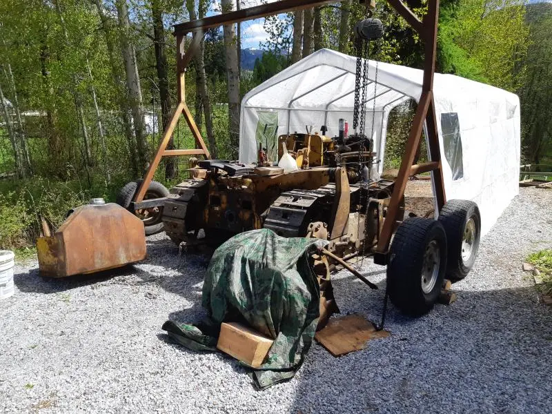

As I am little by little dismantling my 7U, I am anticipating repairing damaged threads. Any preferred types? I remember a certain kind that had I think four little "stakes" to lock the insert into the oversized hole. I've used heli coil but not super impressed. Some inserts also are quite "thick" if that makes sense, which limits their application. Just pondering so I can start looking for when this all goes together. Thanks
