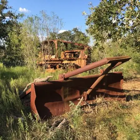

[attachment=40733]image.jpg[/attachment][attachment=40734]image.jpg[/attachment][attachment=40735]image.jpg[/attachment]
A continuation of my electric start conversion using a starter off a 1979 IH1486. With gear reduction using internal 6 spline gear from the input side of a Ford 4000 tractor pto on existing pony motor clutch and trans. housing.
For alternator setup I made up a plate to bolt to front of 3T harmonic balancer then in center of this plate used a 6" water pump pulley off a 69 Mustang to provide proper standoff for mounting my 100amp ford 3 wire alternator using homemade bracket on front engine mount
