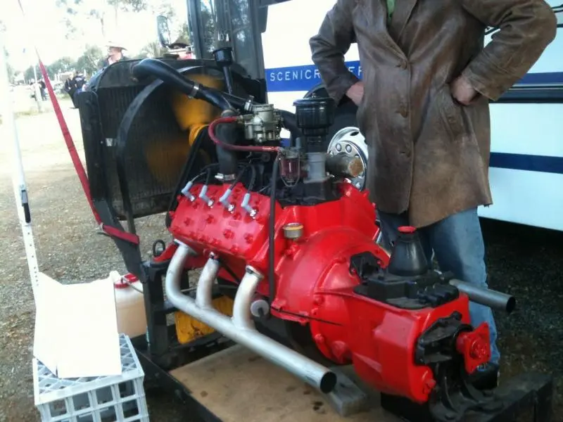

Hi Team,
it is not the first time I have had a crank ground the minimum odd sized amount to clean up and then re-babbitted--using a soldering iron-- and machined the bearing shells in a jig made from an old con-rod.
Keep at it boys, there is more than one way to skin these Cats.

Hi Team,

Hi Daron,
I used a smallish electric soldering iron (sorry I do not know the wattage as I have had it for some 35 or 40 years, from memory it has about 3/8" dia. bits in it) so hopefully I did not run a chance at overheating and destroying the Babbitt qualities.
I used old Babbitt melted out of other Ford side valve V8 engine bearings, this was an old side valve Ford V8 truck engine that had run No's 1+2 big ends of the early full floating style.
As the rods were cactus and I only had 2 good rods from a later precision style(steel backed shells) engine so I modified the crank to pressure feed just No 1+2 big ends. The others were OK and so were left.
There are places here in Australia that will re-Babbitt bearings so there must be some over in the good old USA
Before you all get twisted this engine was blown up years before and removed from a Canadian Ford Blitz truck crane and was deemed scrap.
It probably sat outside for 40 years as was heading for the scrap bin.
Dad said "it's beyond fixing, even as a display engine"
I wanted to get it going again--Dad was not amused, but, was eager to show it off to all and sundry after it was done and ran sweet as a nut.
Mike Meyer has seen and heard this thing run at Echuca Steam Rally recently.
A mate bought it and enjoys the same reaction from younger people who have heard of these engines but never seen one.

Hi Daron,
