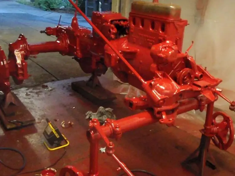

I just put red Imron on my Farmall, and it turned out pretty well, although the Imron was pretty difficult to work with (very temperature and primer sensitive) and I had to redo the fuel tank. By then I really knew what I was doing and it turned out the best. People love the paint job - it looks really "wet." I got some halogen lights on stands - they were essential so I could see what I was doing.
I'm working out of my garage, so I used a combination of wirewheeling for the big stuff, sandblasting for the smaller stuff, and sanding, bondo, sanding primer, and glazing putty only for the sheet metal (it didn't have much rust). I prefer to take as many things off as is practical and paint the small things individually. I don't like to see an alternator painted anything but black, for example, and I don't like paint on wires and spark plug leads, but it depends on your taste. And that's what counts - will you be happy with the outcome if you paint your magneto and spark plug leads yellow? Many would, and that's OK. Every tractor has a different paint job to match the tastes of the owner. I like details to be free of paint - you can't see it in these pictures but I put new black rubber boots on the steering linkages and it really makes it look good. I removed the serial number plate and riveted it back on when I was done.
The Imron thins with acetone - when I ran out of good acetone & used the stuff I got from Orchard Supply, the part I was painting got the weirdest bubbles in it - they were perfectly round and stood out from the paint about 4 mm. Who would have thought that something like acetone would be available in different qualities???
Don't get me wrong, if this is your first paint job, DON'T use Imron.
I'd find a good automotive paint store, an informative store clerk, and take notes! Their product may be more expensive that what you'd get at Tractor Supply, but it's better quality and the staff in those stores know a lot and are a great resource.
Oh, and yes, my garage floor is now red. Guess how much I care?
