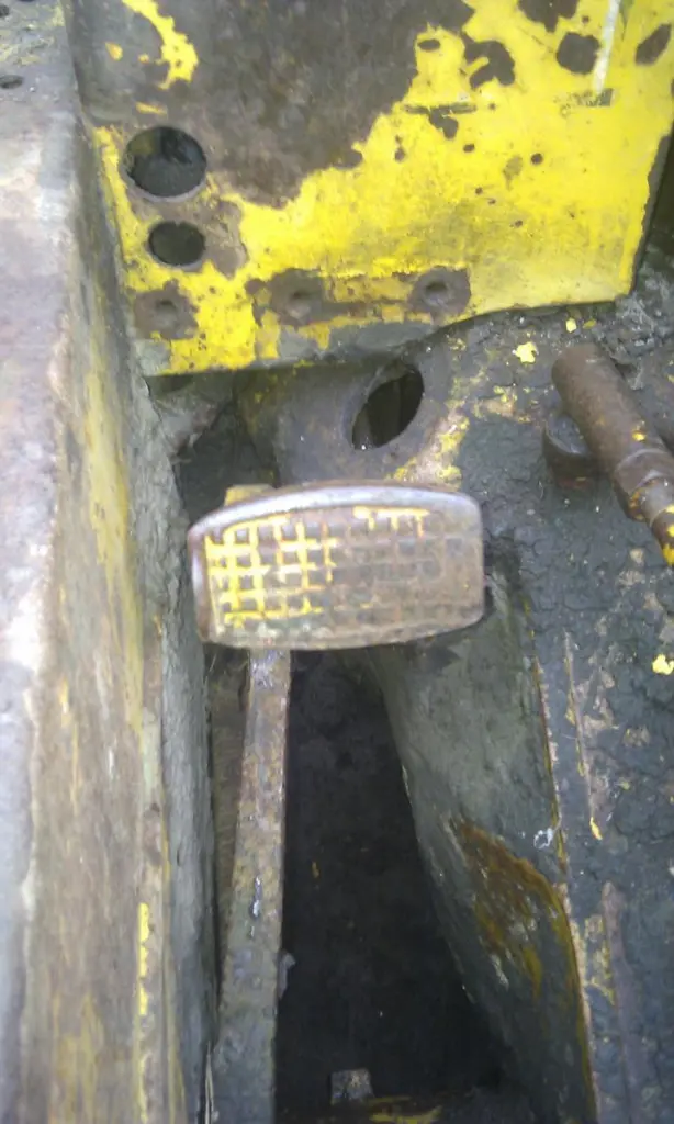

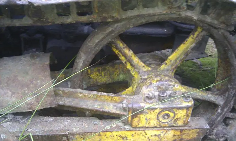

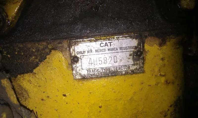

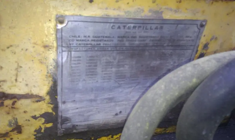

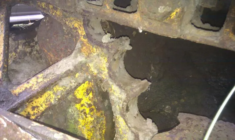

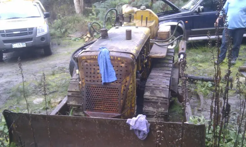

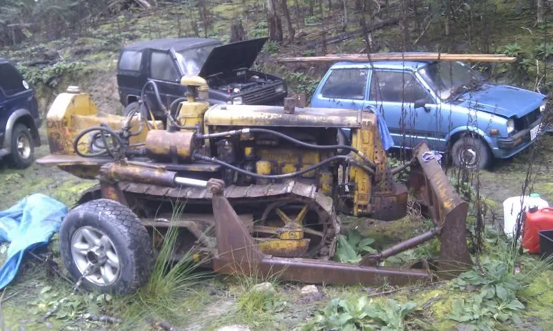

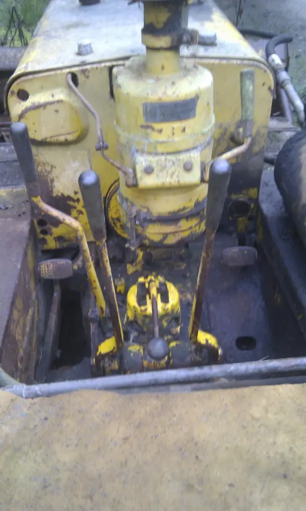

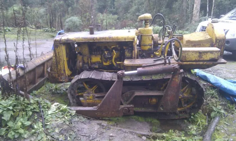

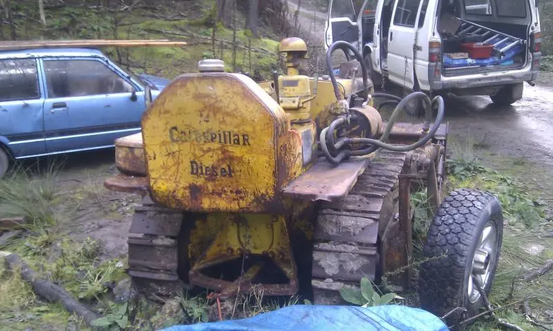

i am looking at buying my first crawler as a restoration project. i don't have land to work it on im just interested in restoring one out of interest. I put a wanted ad on a local website and got a response from a guy locally who had a d2 for sale. Went and had a look its serial no is 4u5820 on the left side of block but the serial no from under the seat was missing. The hour meter is only showing about 530 hrs which seems low to me? the tractor has spend most of its life in an orchard pulling apple bins but also has a blade that doesnt look like an original cat one to me? the track gear looked pretty good too. We could not get the pony motor to run although it did fire but stopped again but the owner told me that the diesel runs well and he would try this week to get the pony started. It has been sitting in a wet shady spot for the last 2 years and the left steering clutch was seized then but the inspection cover has been left off and i suspect that the right could also be seized now? ive taken some photos of the tractor including one brake pedal which some people on this site have said is a good indicator of actual hours worked as hourmeters wern't accurate. The owner wants $4000 AU for it as it is with the one stuck clutch but i think the price would be less if both clutches are stuck? would anyone be able to tell me more details about this tractor and what the blade and hydraulics could be off? Also is this a good price? any advice would be great including replacing clutches which looks hard considering i dont have a proper workshop with crane etc.
[attachment=13487]IMAG0174.jpg[/attachment][attachment=13489]IMAG0176.jpg[/attachment][attachment=13490]IMAG0177.jpg[/attachment][attachment=13491]IMAG0178.jpg[/attachment][attachment=13492]IMAG0179.jpg[/attachment][attachment=13493]IMAG0180.jpg[/attachment][attachment=13494]IMAG0181.jpg[/attachment][attachment=13495]IMAG0183.jpg[/attachment][attachment=13486]IMAG0173.jpg[/attachment][attachment=13488]IMAG0175.jpg[/attachment]

$4,000 AU sounds like a lot for that machine, but then I have no idea about your local market. You will thank yourself for for checking out the unit thoroughly, and any other available as well before jumping in upside-down.

That serial # makes it a late 1952 or early 1953. Where the serial # plate is missing the # should be stamped into the housing .Don't know what type of blade is on it but it appears the blade is way out further past the radiator than a Cat or Balderson blade and with those smaller type front idlers i would suspect that the machine
rock a lot. The later D2 had a longer track frame and a larger dia. solid front idler.
The steering clutches are a job to take out as you have to split the track and remove the final drive assembly. Not uncommon for the brake drum to be rusted fast to the steering clutches and has to be cracked to get apart.
the price seems quite high to me for a machine in that condition with that blade configuration.

I'd agree, the price seems a bit high to me too. On the plus side, it looks to have a good undercarriage with quite a bit of adjustment left for the tracks. Also, all the sheet metal looks to be in good shape with no bad dings that I could see. According to what I could find, it seems to be a '52 or '53 model narrow gauge.
No s/n on the tranny? Look carefully at the left rear of the tranny case. .if the tag is missing, look for either what's left of 4 small rivets or 4 small holes. Cat usually stamped the s/n there before they put the tag on.
Brake pedal wear is a fair indication of hours. . from the looks of the one shown, I'd say it's got more than 530 hours.
Stuck steering clutches on the D2's seems to be quite common. .and the fix can be a real pain. Sometimes they can be broken loose but I wouldn't try to make book on it😆
The blade, I have no idea. Looks to be a fairly well shop built one. Same with the hydraulic tank but it does have a front mounted pump. .all to the good there.
I'm not so sure I wouldn't keep looking, mainly 'cuz of the price and steering clutches (not to mention it didn't run). If the seller would/could get it running and cut the price in half. . .I think I'd consider it.
