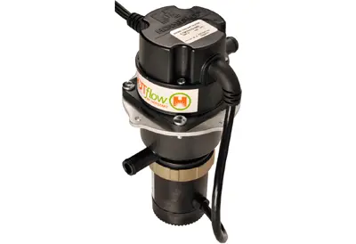

Well my Hotstart coolant heater finally arrived for the old D13000. I am trying to figure out where to install the supply and return lines. They have a handy installation video:
https://www.youtube.com/watch?v=RxukiZsUUbM
This is the kind I have, which runs just shy of $700. Please don't mention that to my wife.
[attachment=40194]Hotstart CTM.jpg[/attachment]
So now I have to find out where to hook it in. There are a lot of port plugs at various points on the engine - is there a place to find out which ports are for the coolant? I've tried looking at the sketches in the Parts Catalog (the original is a work of art), but I haven't had any luck yet. Because the lines are so small I thought it would be best to thread a nipple into a coolant port. I'm just not sure how to tell which ports are for coolant.

Usual connections are at the thermostat housing and the engine block drain.
