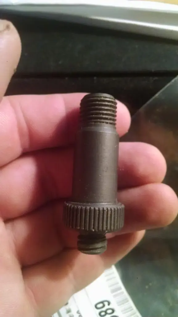

Making my own adapter to do a compression test on a D8.
Plan is to take a injector body and drill it out. Then tap the end for 1/8 not so I can thread in a quick connect fitting to go with the gauge I borrowed.

If you have a spare, it should work if you torch out a tip to put on it. My experience is they are much too hard to drill.
I used an old injector line nut and ferrule to adapt an air line to do a blow down test. Blew a hole in an old tip to put on it.

So this won't work without the tip on the end?
Wed, Jul 20, 2016 9:02 AM
No, nothing to seal into the precombustion chamber.
The injector hold down nut is torqued to 100 pound-foot and compresses the joints between the tip and the precombustion chamber and the body and the tip. The o-rings etc are only to keep dust etc out of the crevices.

I have successfully done a leakdown test by simply slipping the rubber adapter from an automotive compression gauge over a 1/4" pipe nipple. It can easily be held against 100 psi without leaking even without being threaded in.

Just take a 3/4 inch brass nipple and run a 1 inch unf thread down one end of it. That will then screw into the precombustion chamber.

Could I just unscrew the injector and stick a bore scope in the injector hole to inspect the cylinder or no?
You are limited by the orifice size hole in the pre-combustion chamber (approx. 0.250 to 0.300 in. diameter)
