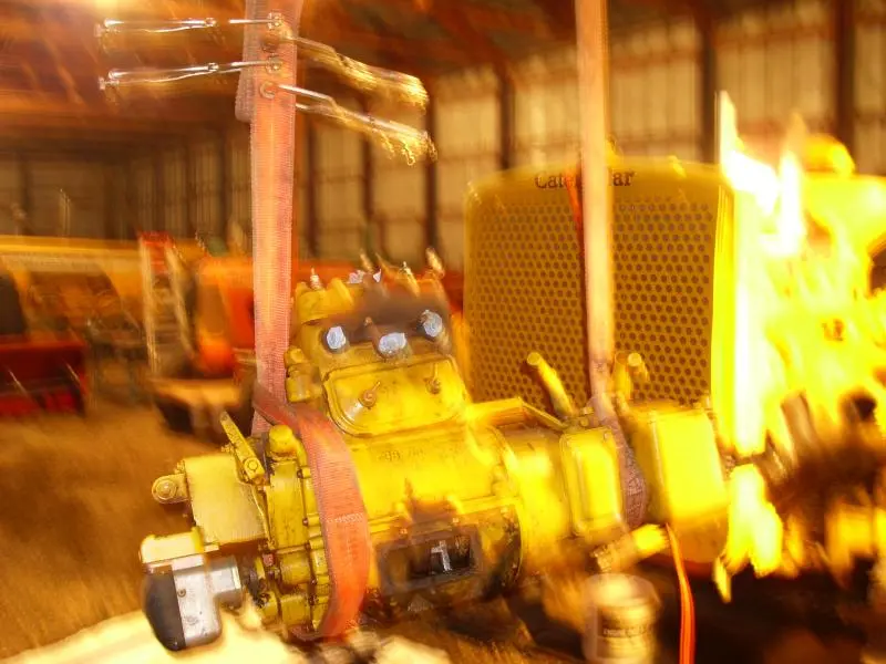

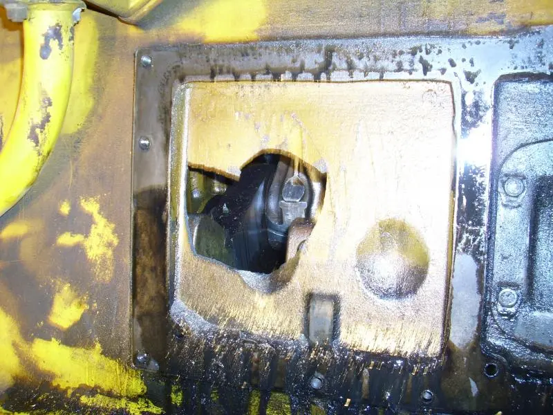

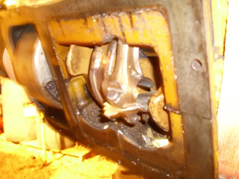

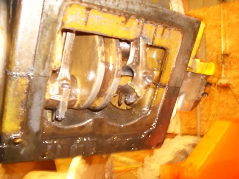

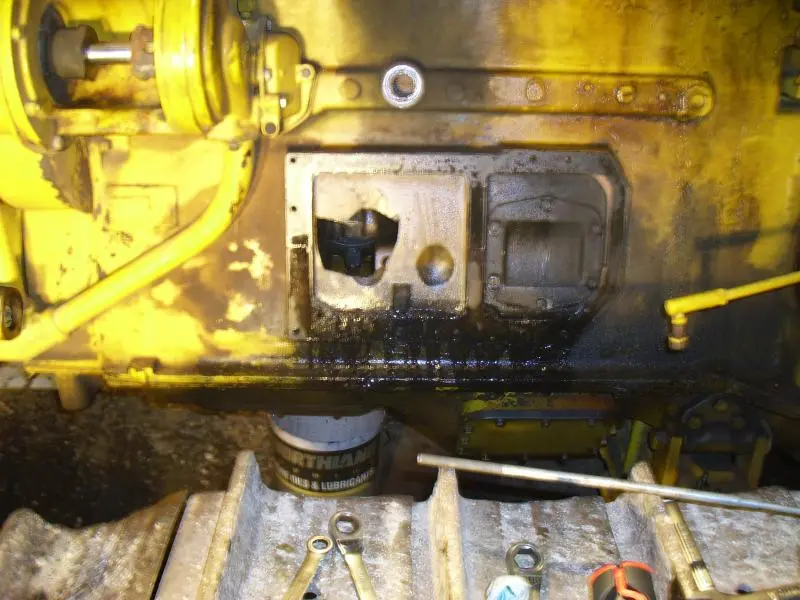

Pony engine rod decided it had enough. A stud holding the rod cap broke resulting in a grenade effect poking a hole in the diesel block. I'm thinking of taking up model railroading as hobby instead of old cats. I guess its time to find a good welder. The crawler is a 1936 RD7. Other than the giant hole in the block its a good ole runner.

Looks like a lucky break to me!
If it seeps a little bit after welding it, it won't make a mess. You'll just have to top up the pony oil before cranking it.
Mon, Feb 28, 2011 3:41 AM
Posts: 16,695
Maybe blank plate and direct electric start.........

As long as you have all the pieces of the block it will be an easy fix. Just do a little beveling on the edges to get some brass in the crack. Use lots of brake clean or carb cleaner on the cast to get all the oil out. I like to heat it alittle with the torch before starting to braze.
Also with the brake clean you'll find the just how long the cracks in the block are. At the end of each crack, drill a very small hole and this will keep the crack from creeping further due to heat. That block is thick enough i would try brass rod for a stick welder or use nickle rod.
I fixed a 353 block you could throw a basket ball through using the lock and stitch method. It takes alot more time but works wellhttp://www.maineindustrial.com/metal_stitching.htm
