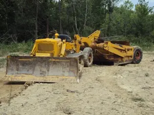

Traded a Southbend 16 Inch Lathe for this D6-9U. 1950 model 9U6440 with a dry clutch that has been rode hard and put up wet for a long time.. Needs a lot of TLC,but for what I had in the lathe I traded for it, it won’t be impossible to make it a good machine again. Under carriage is in excellent shape except for the Track Carrier Rollers, and the motor is a candidate for a rebuild. Both motors are free, steers, brakes and drives good except for the blow-by from the motor. The cable control unit for the blade seems to work ok. The previous owner has all the track frame covers, and floorboard panels which are missing, so basically the machine is complete. AGKITS offers an after market pistons, sleeves and rings as a kit for this motor. Has anyone rebuilt a 318 motor using this kit? I rebuilt a Case 504BD with their kit with excellent result, just curious about the Caterpillar kit. Plans are to pull a Cat 60 Scraper with this machine
I have most the parts for the motor which are missing or broken but anyone who has 4 Track Carrier Rollers for sale, I would be interested in hearing from you[attachment=53275]20190331_171818.jpg[/attachment]
Tue, Apr 2, 2019 10:22 PM
Nice Fleco cab.

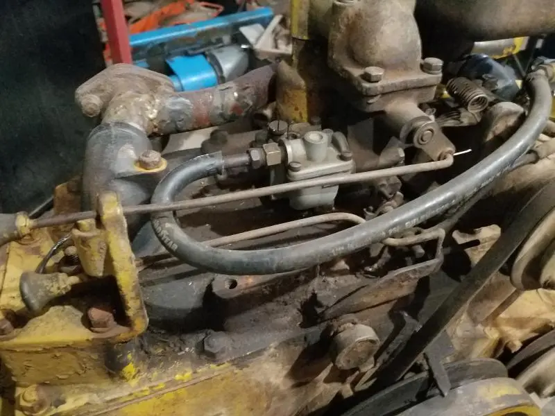

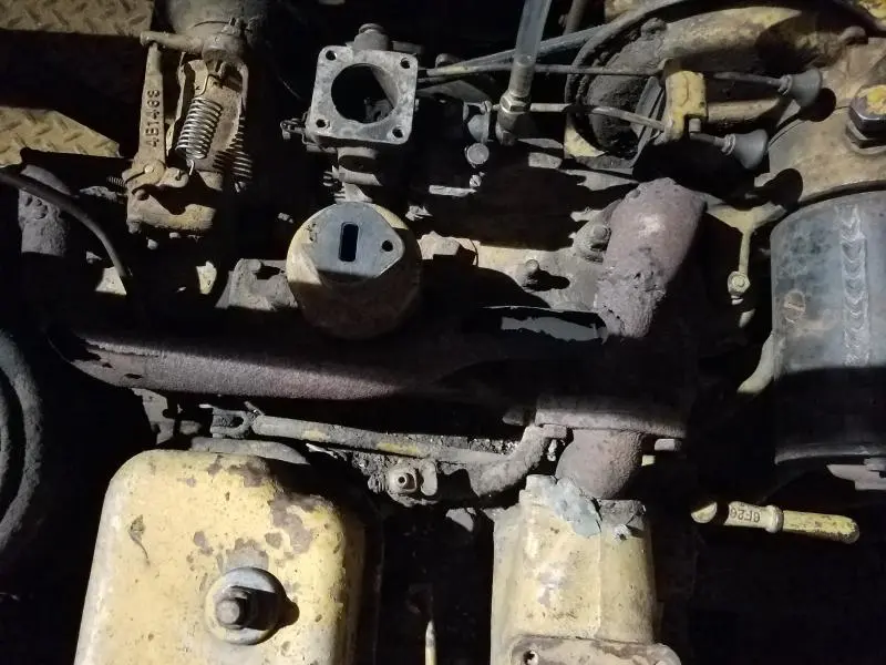

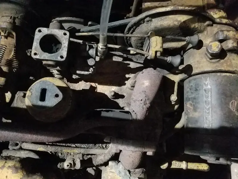

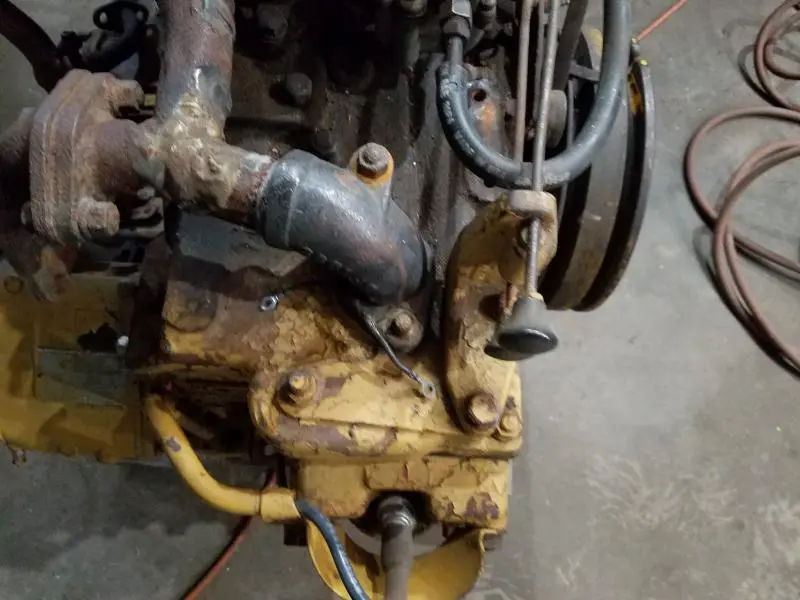

Any chance you could post some pics of the pony on your 9U? I'm combining pieces of two pony's for a DW10. One of them ponys is original to the DW10 the other is from a D6 9U I think. There are some very minor differences and I have the DW10 parts books but not the D6. I'm curious about starting controls, throttle, choke and water connection tube at the back.

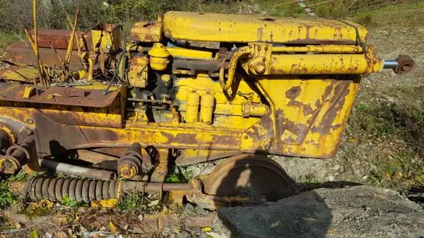

Brian--this is my 9U parts machine--I doubt if any of the carrier rollers are any help but if you need anything else your welcome to them
it[attachment=53304]D6 001.jpg[/attachment][attachment=53305]D6 9U 2.jpg[/attachment]

Dan Looks like only one is any good. Let's wee what turns up in the for sale /wanted section of this forum. Thanks for the offer. if I run across anything I need I will let you know

Dan: Does your parts machine have an oil clutch? I have a 5VXXXX D318 engine with an oil clutch that is missing the entire clutch to include the flywheel. I enlarged your photo of your parts machine and I think I saw the dipstick to check the oil for an oil clutch. Send me your phone number or text me at 573-433-nine two seven seven. I would like to talk to you about some parts.
Oldcarman: here are a couple of photos of my D6 pony motor. One without electric start and one with electric start. I think the motors are identical.
