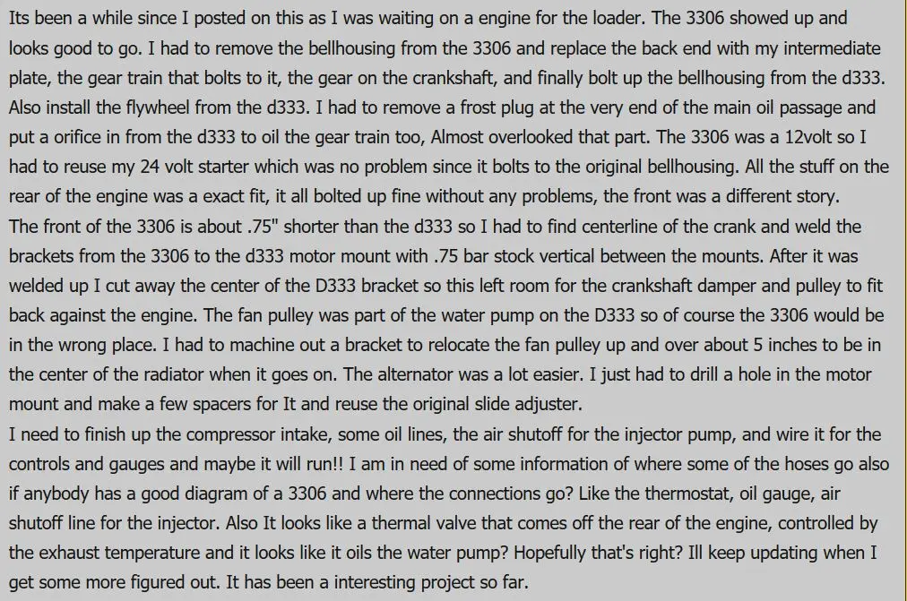

Yes, apparently it will bolt up at the rear, with some alterations. Most of the challenge is making things work up front.
Here's some notes I kept from a conversion. Also happened to also be a 966B.
  [attachment=64127]Part 1.JPG[/attachment]

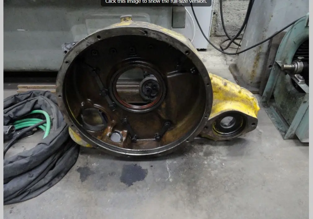

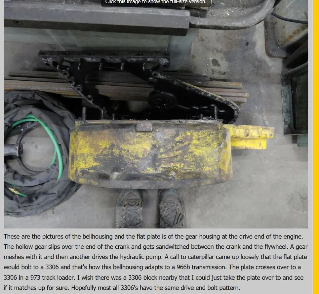

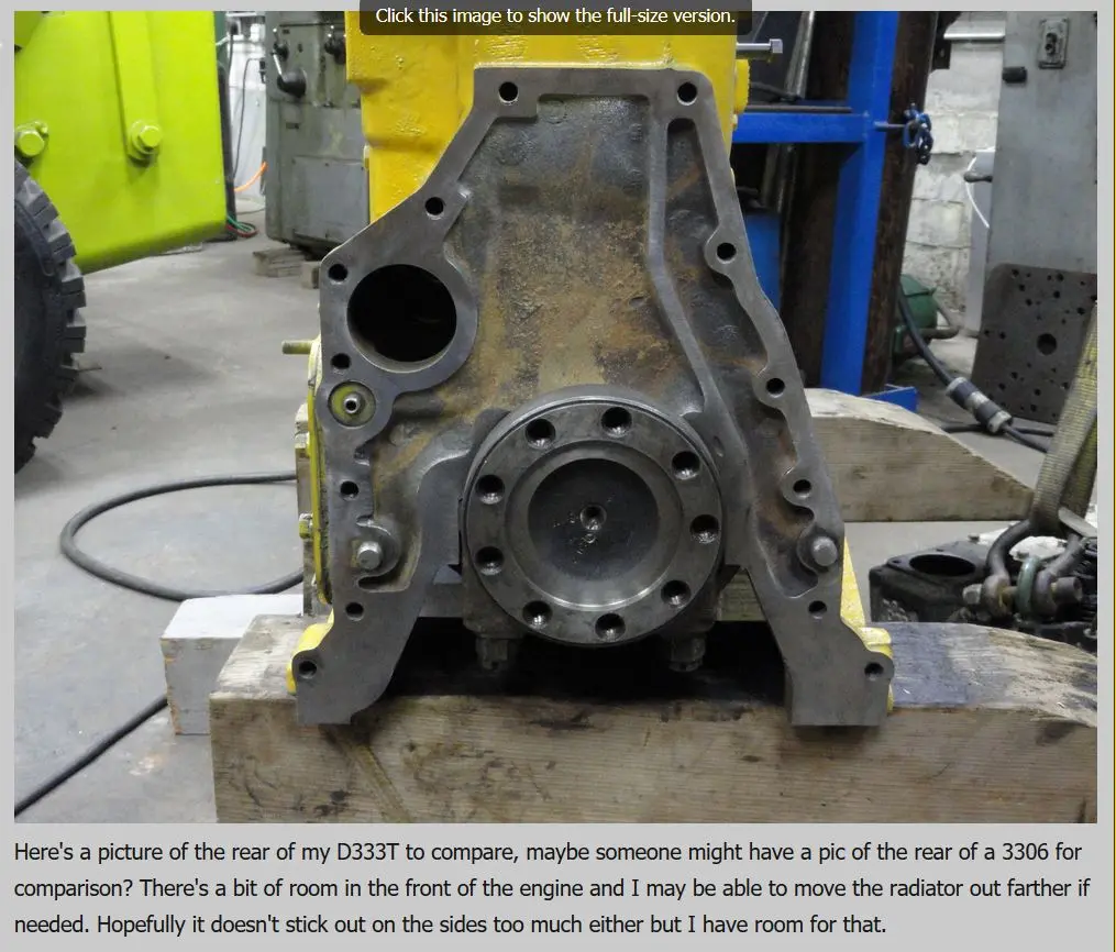

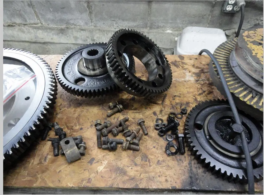

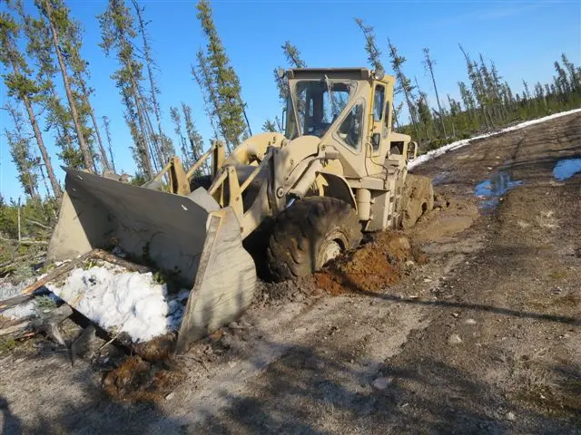

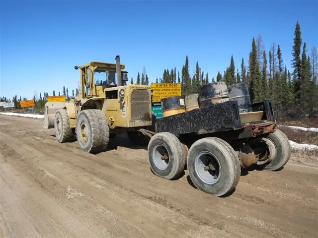

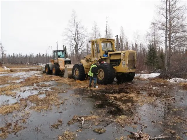

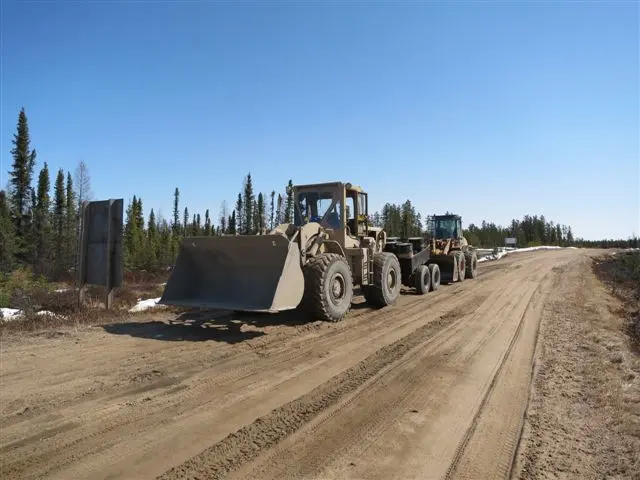

And some pictures..... [attachment=64128]Picture #1.JPG[/attachment][attachment=64129]Picture #2.JPG[/attachment][attachment=64130]Picture #3.JPG[/attachment][attachment=64131]Picture #4.JPG[/attachment]
Thanks Old Magnet That sure is a different story one guy told me it will fit up no problem one other guy said minor adjustments now this one from old Magnet I think I will not bother switching engines and just part the loader out be cheaper in the long haul
