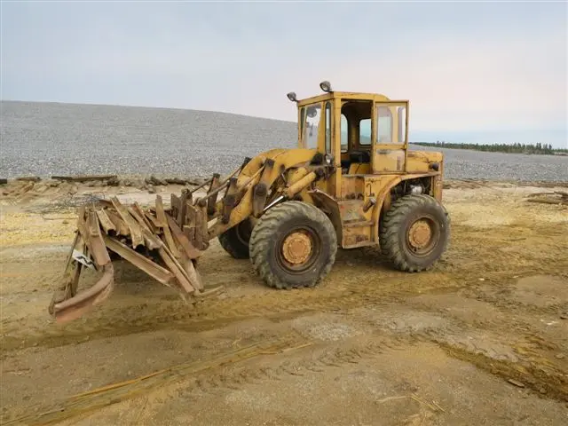

I attached a picture of me rescuing my truck from the neighbors driveway (which is why I don't plow any driveways that I cant drive to with the loader.๐Ÿ˜„
