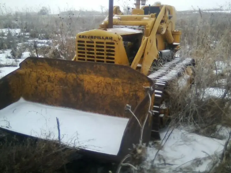

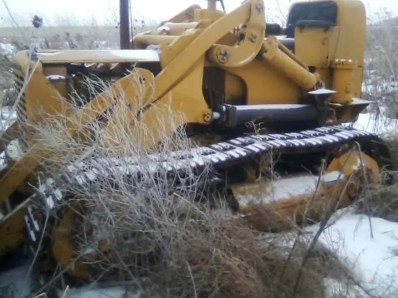

[attachment=52407]IMG_1310.jpg[/attachment][attachment=52408]IMG_1309.jpg[/attachment]

If that machine was here in the rust belt of New England in that condition.... there would be little hesitation to ad it to the stable of Caterpillar children.

The 12a use the same motor D4-6-7U a D 315 and it is a good machine

Yes, it's a 955E 12A track loader. It has the D315 engine and a D6 size undercarriage.

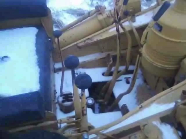

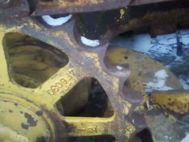

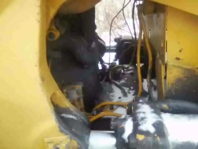

[attachment=52410]IMG_1311.JPG[/attachment][attachment=52411]IMG_1313.JPG[/attachment][attachment=52412]IMG_1312.JPG[/attachment] Any idea of an approximate weight ? How about finding parts,are the undercarriage parts available from cat ? My SIL ran out into a field a quarter mile to take pics but didnt think it had a pony motor - and it had batterys . So does it have a starter ? Janmeermans comment on manufacture by a green company confused me - Lee

As others have pointed out, a 12a Caterpillar serial number denotes a 955 track loader which is certainly the machine pictured.
I can't think of a 755 Caterpillar tractor of any type, but John Deere (the green manufacturer) made one or more 755 models.
It must be a direct electric start model because the picture through behind the engine and in front of the firewall shows daylight clear through and big battery cables running to a main battery disconnect switch. If it were a pony motor start D315 engine, that space would be occupied by the 2 cylinder pony motor.

This 12a have a D4 undercariage and the starting engine ben removed

That s/n would have the D6 undercarriage, Changed from D4 to D6 undercarriage at s/n 12A5793. Good machine but a pig to work on especially any internals. Approximate weight 21,480 lbs.
Shares a lot of parts with the U-model D4's.
